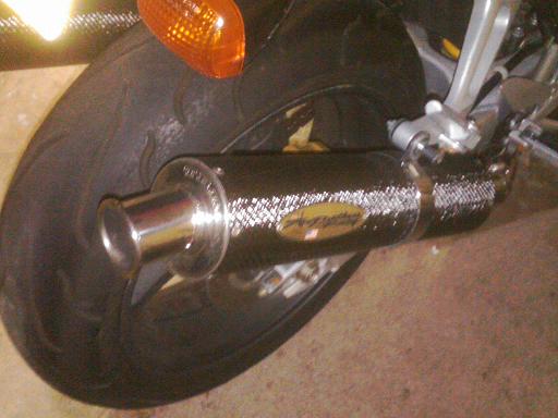

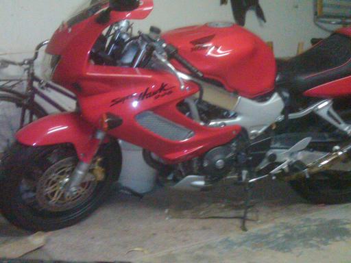

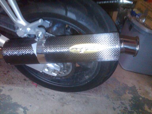

Just rode it home- so excited- glad it is cold out now- will look good sitting in the garage. nice comfy corbin seat- and it came with three wind screens, tank bag, and stock exhaust.
which means the Carbon Two brothers slip ons are for sale.
I am not sure what is a fair price for them- was thinking $500 ish does that make sense?
will post slip ons in classifieds shortly.
SO EXCITED! glad to be a SH member and Rider.
