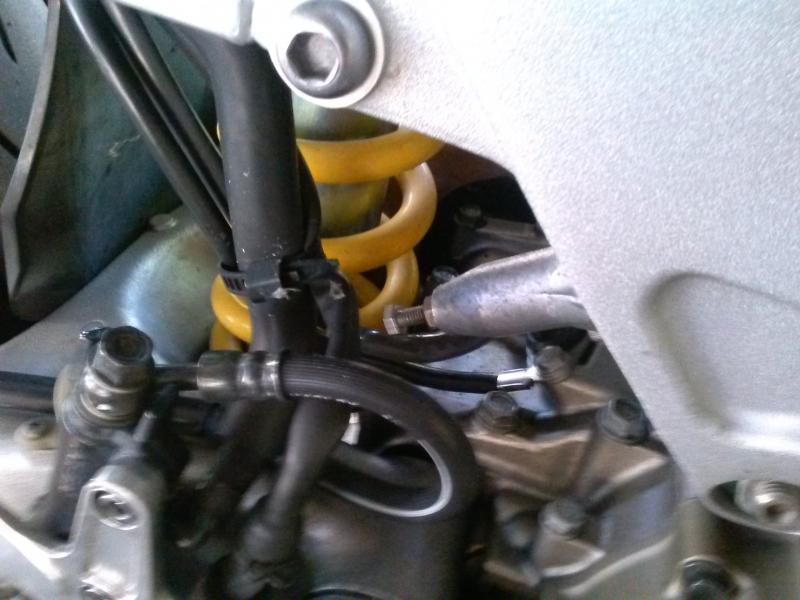

Did you keep your old ones?...Manual oem ccts. total investment..$1.27 and a few hours of install time.

TAMPAHAWK68 is definitely talking about a full manual conversion as you can see in the picture included with his post that he has drilled out the OEM housing and replaced the plunger with a bolt.
The stopper mod, which I just learned about recently, works as jscobey describes. I just can't see doing it as it is still just as likely to fail, though it shouldn't grenade your engine if it does. I think the time is better spent doing some form of full manual mod.

I'm pretty confident TAMPAHAWK68 is not referring to running a bolt into the plunger, but, rather, replacing the plunger with a bolt. This turns the OEM ACCT into a MCCT. It's the same principal as an APE or Kreiger, just using the OEM housing instead of a hunk of billet.
I'm not familiar with the mod Tweety is talking about. The stopper mod uses a pin or collar to prevent the plunger slacking off to much if, no, when the spring breaks. If I read about the stopper mod correctly, that is. I admit I didn't spend a lot of time examining the stopper mod.

Turning stockers into manuals is a great way to go, but there are a couple of downsides:
1) You do have to drill a decently straight hole and tap some threads into the stockers. Easier said than done, although it's not a precision machine process. Can be done with a hand drill, but can also be messed up with a hand drill (spoken from experience).
2) You have to source all of the parts and tools to do this. Bolts, taps, etc
3) You have added another step in the install process that takes quite a bit of time, and if you botch the conversion you're SOL until you get some other form of CCT in there.
I think the third one is biggest for a lot of people. This is a job that may people do with little experience. So tapping and threading a part that they don't entirely understand halfway through the install process doesn't usually sound appealing when the alternative is to spend 100 bucks. Especially for those people who only want the bike to be down for a day and already work slowly due to inexperience. But if you have an extra set, or are confident in your tool dexterity and mechanic experience, or have an alternative transportation if you mess the job up, the conversion of the stockers is awesome and I do think they look better.
