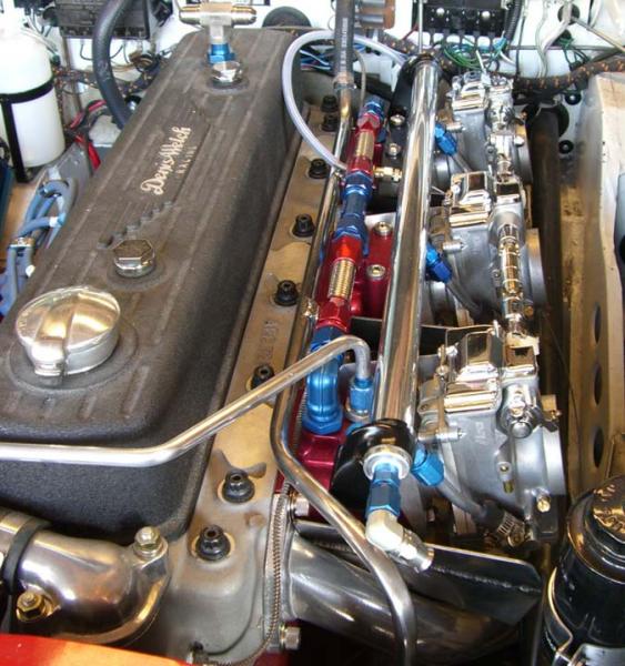

From: Los Angeles ish
Originally Posted by mikstr
You also have to consider the whole issue of fabricating the brackets to hold them together, as well as the linkage to have them open together. While not impossible, it could sure be a source of frustration.....
Or a challenge. Here is a conversion I did with 3 Mikuni HSRs on my Austin Healey.
