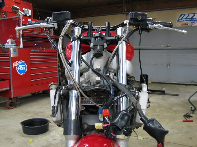

Here's one with the fairing stay removed.
Rex
Rex
Cool thanks.
