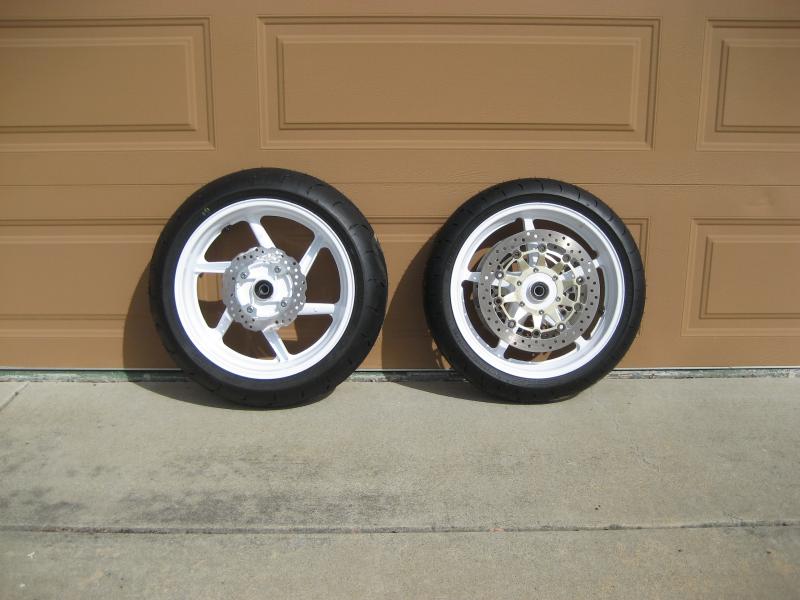

Old Apr 6, 2013 | 09:12 AM

Old Apr 6, 2013 | 02:26 PM
Originally Posted by whatthefnck
is that a teaser pic?? hahhaa
Well you couldn't use the front wheel but no it's just what I run

Ok so that 900rr wheel bolts right up. What is necessary to use that matching f3 wheel? I've located a shop with the pair of rims, and now my head is kickin ideas.
Old Apr 6, 2013 | 07:33 PM
Bolt it on.....
