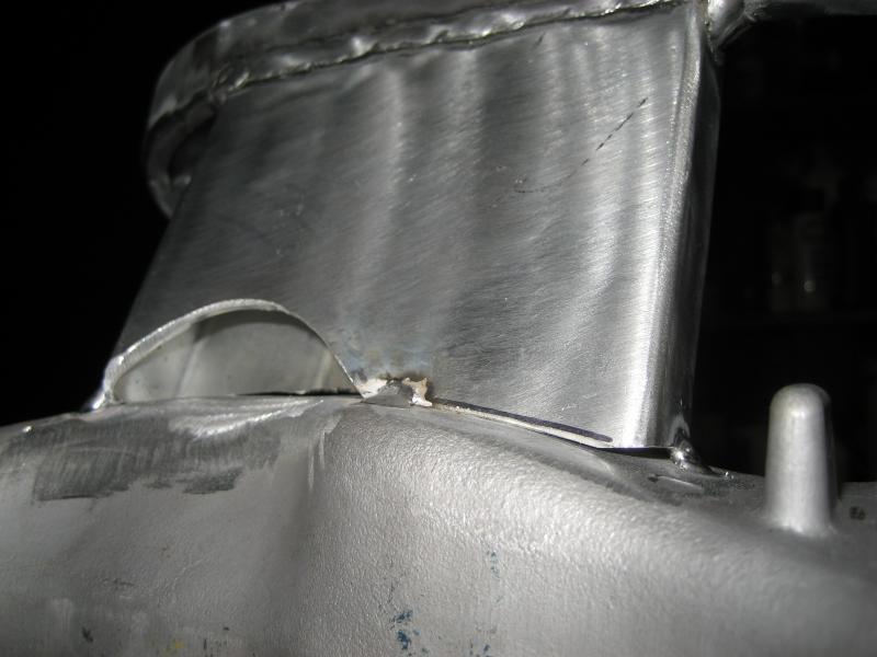

Old Feb 28, 2010 | 05:18 PM
You also need a 900rr rear brake bracket as the caliper will hit the brace with the stock set up. Which means you also need to change the mount on the inside of the swingarm as the VTR uses a female boss and a 900rr uses a male boss.
Then you will also need to relieve the front of the brace so it conforms to the contour of the shock cut out in the VTR swingarm.
The last pics are of mine tacked up to check the relief for proper clearence before final welding.

Old Feb 28, 2010 | 06:10 PM
I cut in and tried to just cut the weld material and not the brace itself, then it just poped off with a little tap with a hammer

CBR900rr Swingarm Brace mock-up
Swingarm compatible whit VTR F?-img_0397.jpgCBR900rr Swingarm Brace mock-up

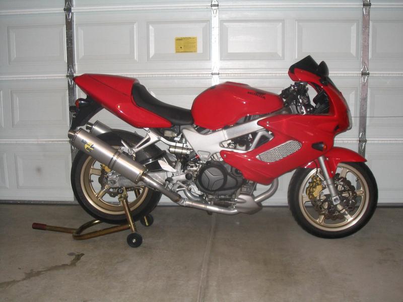

Comepleted

2whltuner,
What kind of wheels are those? I like them alot. Nice looking bike by the way.
