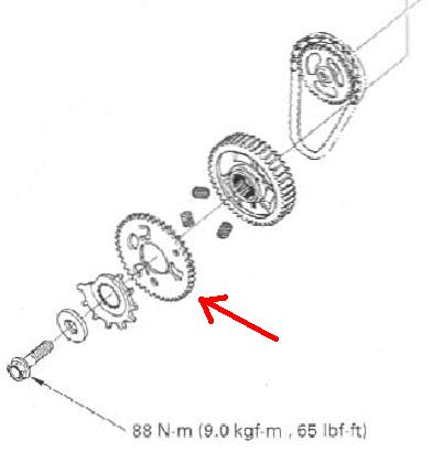

Uchi,
Make sure your quieting gear is properly installed. This is a spring loaded gear on top of a gear which is located under the ignition timing plate.
[edit] Inserted a pic for clarification

Uchi,
thats the bastard that had the little things pop out of it. looks like we might be going back in there. thanks for the picture. thats one of those things id never know about.
