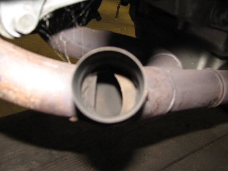

2 into 1 is a pretty easy way to go, cut away the left side outlet and weld a cover over the hole, run a hole saw or die grinder down the right outlet to get rid of the intrusion and put your mid pipe and muffler on.
Here's a chitty pic looking into the right outlet.
Rex

Originally Posted by bjorn toulouse
You may want to reconsider that "straight piping" idea.
You will find yourself in jetting hell.
Rex
Already did that with a 32mm hole saw.. I got some power gain on that one but not a whole lot.. I got a stock exhaust in my garage I'm thinking about building me some sort of baffle so i will get at least some back pressure.. Make the stocker shorter and put it in front of the rear tire where the shock is at and then spit it into 2 pipe out the back...
