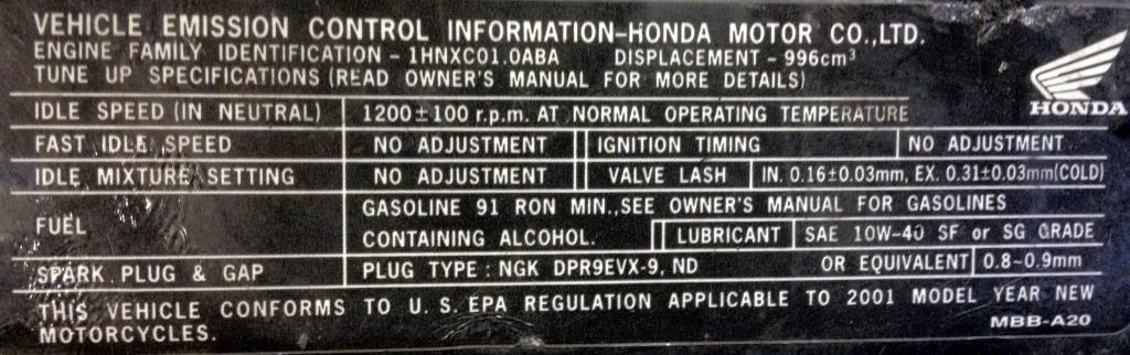

Looking at sticker on bike it reads Gasoline 91 RON

Sticker under the seat reads Gasoline 91 ron.
Reading on wikipedia it says that MON is always lower then RON, so 87 R+M/2= will always have a 91 or greater ron rating (see wiki for table).
Ethonal will not hurt your hawk!
from the owners manual (pg 36)
Petrol containting Alcohol
if you decide to use a petro containng alcohol (gasohol), be sure it's octane rating is at least as high as that recommended by Honda. There are two types of "gasohol". one containng ethanol, and the other containing methanol. Do not use petrol that contains more then 10% ethanol. Do not use petrol containing methanol (methyl or wood alcohol) that does not also contain cosolvents and corrosion inhibitors for methalon. Never use perol containing more then 5% methanol, even if it has cosalvents and corrosion inhibitors
So ya Honda says 87 (usa, canada) is what is needed!
Ps. I'm still running 91..
