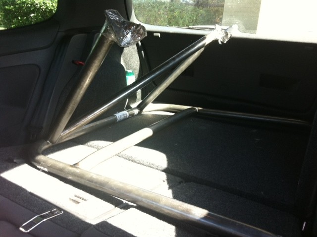

New headliner is going in and roll bars are going to powder coater

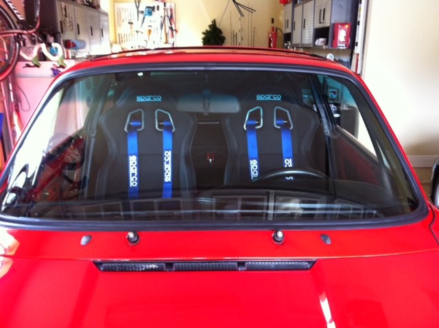

closer to done

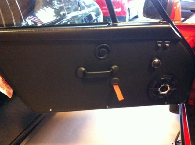

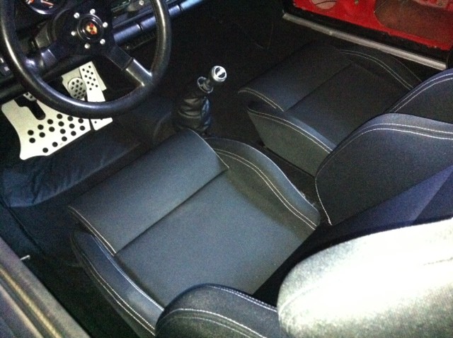

Interior almost done & motor near complete too!
Attached Thumbnails Turbo Cage Build-01-03-12-3rd-light-wiper-delete.jpg   Turbo Cage Build-01-08-01-rs-door-installed.jpg   Turbo Cage Build-01-13-12-motor.jpg   Turbo Cage Build-01-13-12-interior.jpg   Turbo Cage Build-01-13-12-race-seats-harnesses.jpg

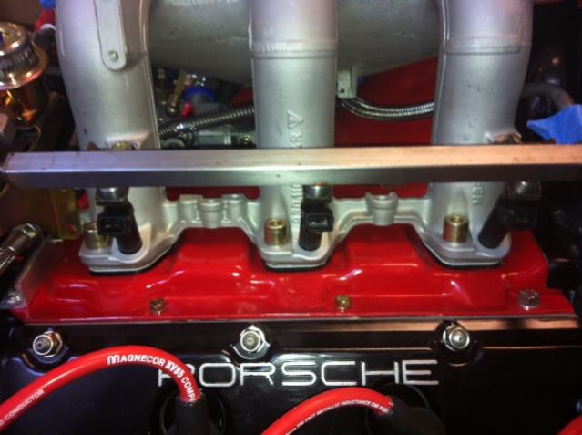

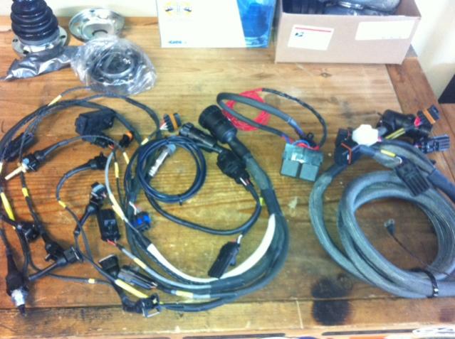

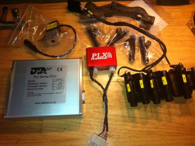

I've got most of my EFI converion parts in
Now I just need some fab time to get them all mounted
Attached Thumbnails Turbo Cage Build-02-02-12-dtafast80s.jpg   Turbo Cage Build-02-02-12-efi-wire-harness.jpg   Turbo Cage Build-02-02-12-injectors-1-2-3-.jpg   Turbo Cage Build-02-02-12-coil-packs.jpg

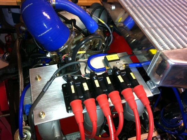

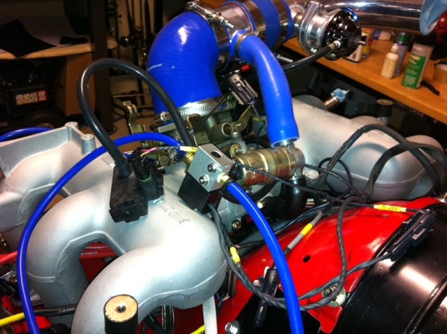

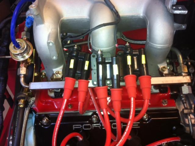

more progess & more pics
Coils and sensors mounted and have a few more parts coming in to finish her up!
Attached Thumbnails Turbo Cage Build-02-09-12-wire-harness-sensors-going-.jpg   Turbo Cage Build-02-09-12-intake-air-temp-flow-sensor-install.jpg   Turbo Cage Build-02-14-12-coils-sensors-shelf-fab.jpg   Turbo Cage Build-02-14-12-coils-sensors-shelf-done.jpg

I am really digging that interior.

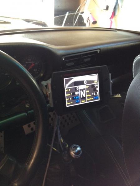

If you like it so far you'll prolly like it mo-betta when I install the new electronic dash!

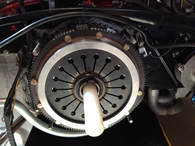

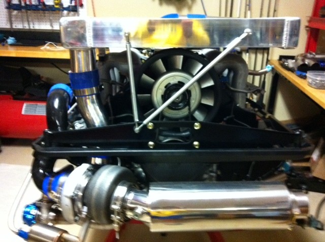

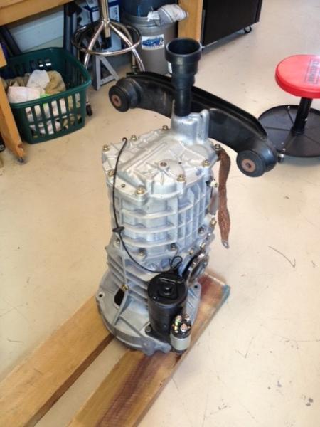

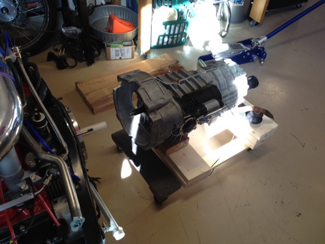

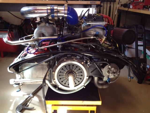

Progress

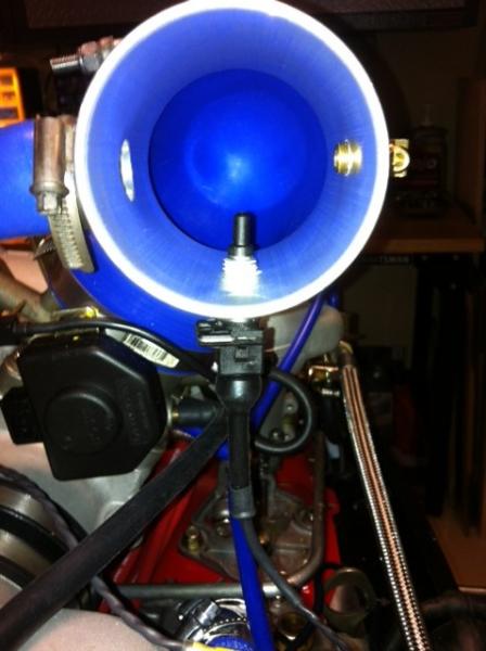

The motor is off the stand and I'm ready to mate it to the gearbox as soon as I get the correct length studs. Then I can put the motor in the car. I still have some fabbing to do in order to mount the new electronic dash on the dashboard and I still need a fuel pressure sensor, but none of that wont stop me from getting the motor in the car
Attached Thumbnails Turbo Cage Build-04-23-12-motor-off-stand-ready-install.jpg   Turbo Cage Build-04-23-12-kep-stg1-pp-installed.jpg   Turbo Cage Build-04-23-12-tranny-ready-mount.jpg   Turbo Cage Build-04-23-12-gear-box-furniture-dolly.jpg

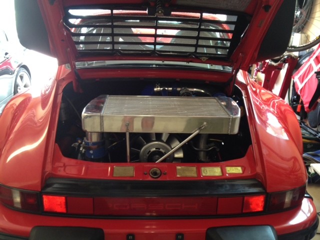

Motor is in
Rolled the motor over last night with the starter w/o fire or fuel to test oil pressure and it's good to go, but didn't fire it up cuz I found a leak that I'll have to chase down first.

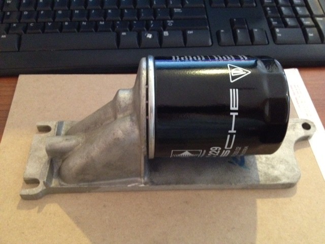

oil leak found
I tracked the oil leak to the motor mounted oil cooler which I'm replacing with a 993 oil filter console. If all goes well I'll fire it up this week!
Attached Thumbnails Turbo Cage Build-05-07-12-x-dash-lit.jpg   Turbo Cage Build-05-08-12-993-filter-console.jpg   Turbo Cage Build-05-08-12-993-pic-downunder.jpg
