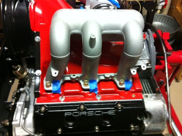

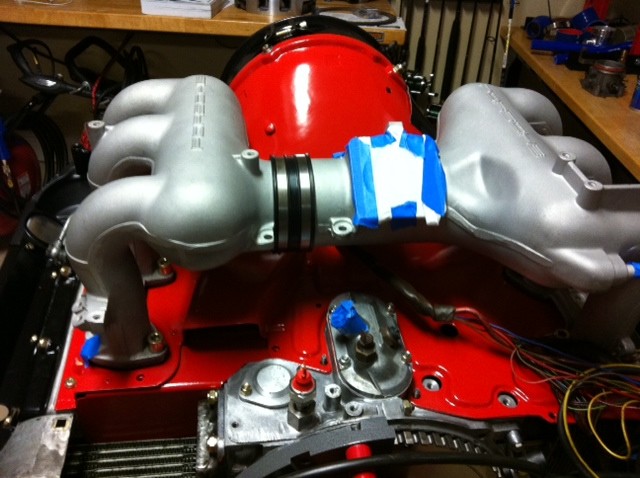

update
I got the intake manifold on it yesterday
Attached Thumbnails Turbo Cage Build-10-24-11-carrera-intake-side.jpg   Turbo Cage Build-10-24-11-carrera-intake-back.jpg

  #128
RWhisen's Avatar
Former Superchicken Owner
Posts: 1,607
From: Ft. Worth, TX
Pretty!

  #129
RCVTR's Avatar
Joined: Dec 2005
Posts: 1,689
Man, that thing is beautiful.

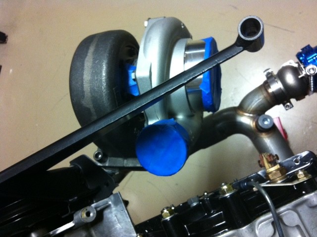

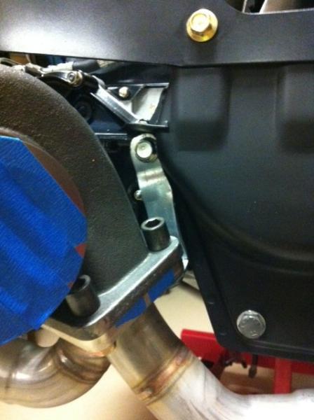

clocked the turbo
Last night I got the turbo clocked and fabbed up a hanger outta some 1/8" bar stock.
Attached Thumbnails Turbo Cage Build-10-24-11-clocked-turbo.jpg   Turbo Cage Build-10-24-11-turbo-hanger-8th-inch-bar.jpg

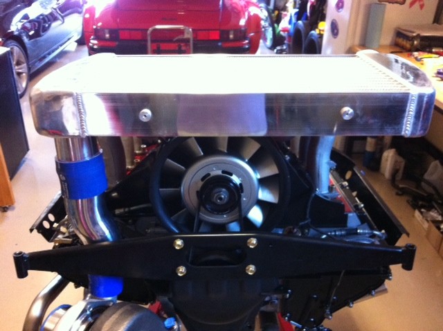

Old Nov 1, 2011 | 11:04 AM
  #133
FL02SupaHawk996's Avatar
Fastest Color
Posts: 2,091
From: Lithia, FL

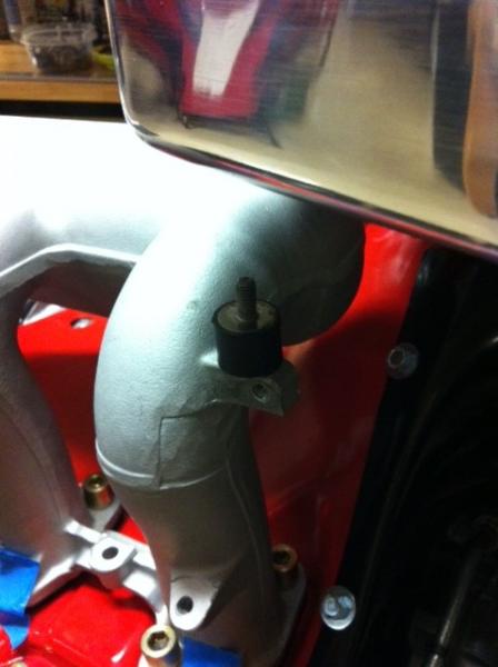

Intercooler fitment
I think this intercooler should be big enough

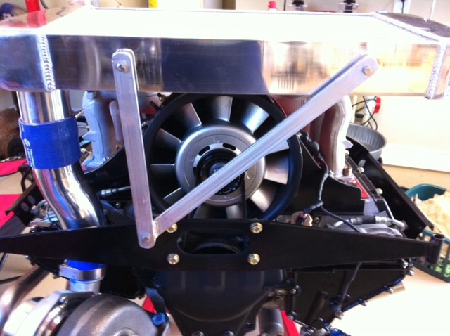

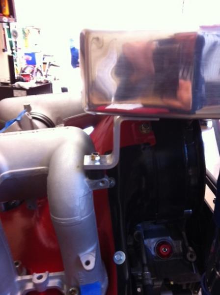

Posts: 2,091
From: Lithia, FL

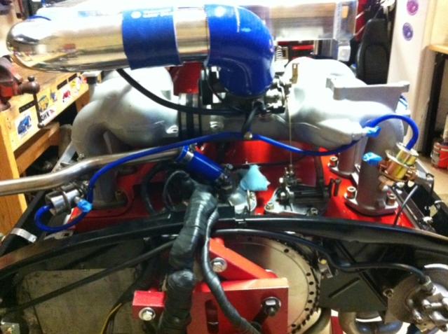

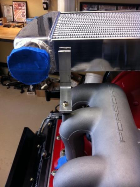

fabbed up som Intercooler mounts
nice weekend for workin in the garage, but the weather did make me miss the ole Superhawk...

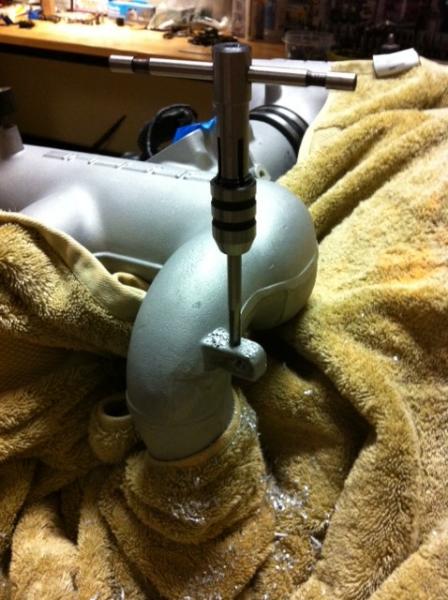

mounts fashioned outta some 1/4" alum bar stock
Attached Thumbnails Turbo Cage Build-11-05-11-carrera-intake-tapped.jpg   Turbo Cage Build-11-05-11-carrera-intake-added-mount2.jpg   Turbo Cage Build-11-05-11-ic-mount3.jpg   Turbo Cage Build-11-05-11-ic-mount2.jpg   Turbo Cage Build-11-05-11-ic-mount.jpg

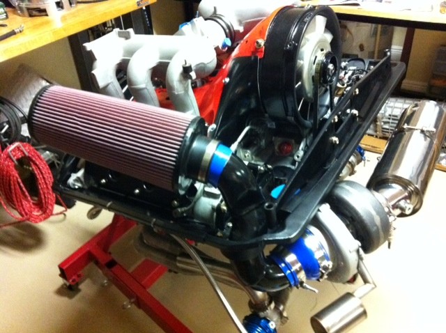

Old Nov 14, 2011 | 08:37 AM
  #144
Fastest Color
Posts: 2,091
From: Lithia, FL

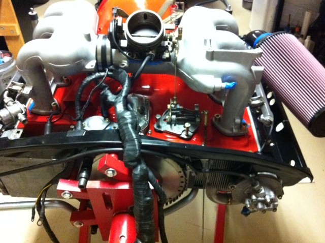

Air Filter
Is this K&N too small?
Old Nov 14, 2011 | 09:57 AM
  #145
RCVTR's Avatar
Joined: Dec 2005
Posts: 1,689
Too small for what??
It is too close to a lot of hot things. Might as well start out with cool air. You wouldn't want that thing to be down on power...
Old Nov 14, 2011 | 10:05 AM
  #146
Fastest Color
Posts: 2,091
From: Lithia, FL
Nope, we don't want it to be down on power. My goal is to have enough power to make me smile ear-to-ear and anything more is a waste
I was considering building a box for it so it can only suck cool air from the whale tail, but with that big honking intercooler isolating the filter in a box would just be overkill IMHO.
Old Nov 14, 2011 | 10:57 AM
  #147
RCVTR's Avatar
Joined: Dec 2005
Posts: 1,689
You really need to have the coolest air at the highest pressure available at the inlet to the compressor. Hot air from the engine compartment won't cut it. You can't make up for a loss in mass flow rate with intercooling. The intercooler is only for increasing the density of the compressed air.
Old Nov 14, 2011 | 11:05 AM
  #148
Fastest Color
Posts: 2,091
From: Lithia, FL
I know you're right, but it's easy to talk myself out of the extra work since the only time it will suck engine heated air is when it's not moving since the whale tail will force cool air in to displace the warmed air at speeds.

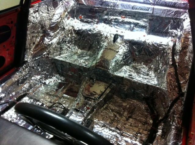

Old Dec 3, 2011 | 08:09 PM
  #150
Fastest Color
Posts: 2,091
From: Lithia, FL

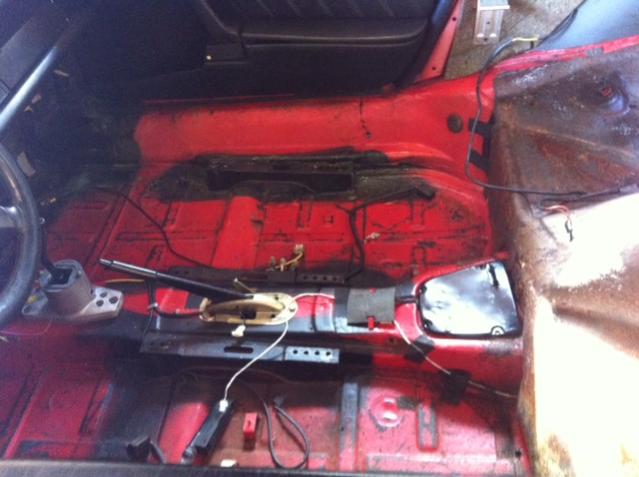

out with the old and in with the new!
ripped the old interior out and installed a heat/sound barrier before the new carpet goes in. Headliner will be new too. Also, ran the fuel reg vac lines.
Attached Thumbnails Turbo Cage Build-11-24-11-old-interior-srtipped-out.jpg   Turbo Cage Build-12-03-11-acustic-thermal-layer-.jpg   Turbo Cage Build-12-03-11-fuel-reg-vac-lines-.jpg
