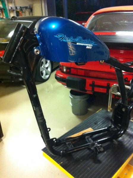

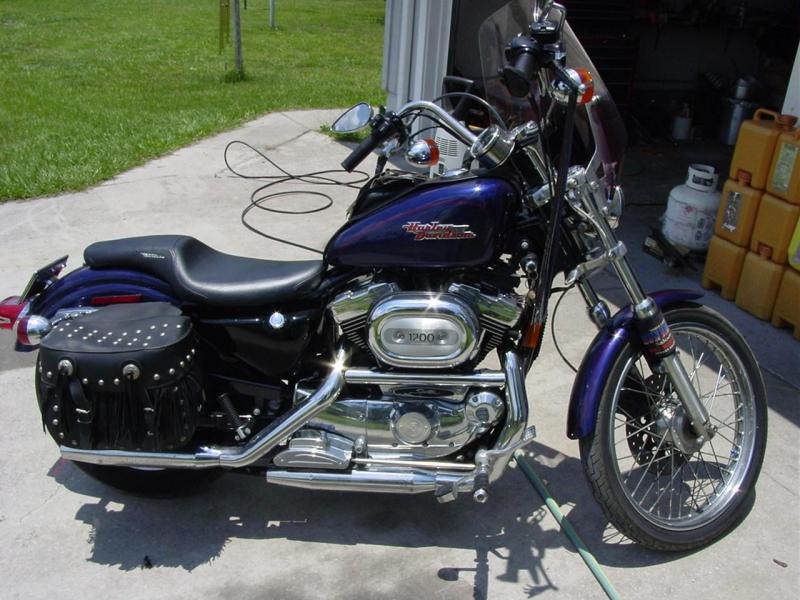

1999 Sporty Chop/Cut/Rebuild

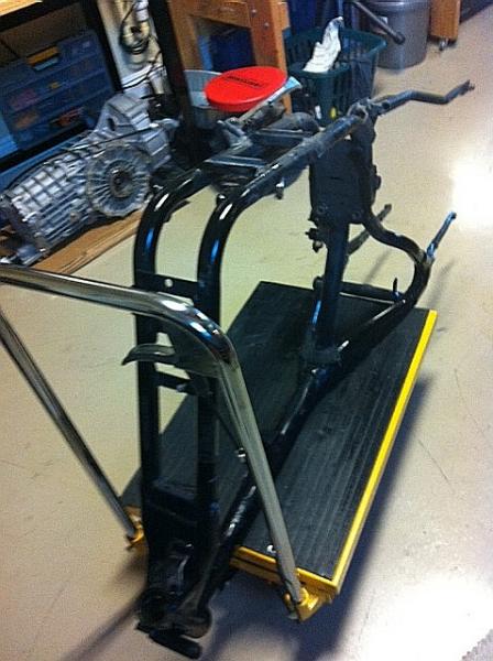

It was a 1999 HD Sportster 1200 Custom, but not anymore
When I get done with it you'll have a hard time figuring out what it was and it should have about twice the HP & Torque
Attached Thumbnails 1999 Sporty Chop/Cut/Rebuild-sportster-po-pic.jpg   1999 Sporty Chop/Cut/Rebuild-03-13-12-frame-stripped.jpg   1999 Sporty Chop/Cut/Rebuild-03-13-12-motor-out.jpg   1999 Sporty Chop/Cut/Rebuild-04-04-12-combustion-chambers-before-porting.jpg   1999 Sporty Chop/Cut/Rebuild-04-04-12-intake-port-before-porting.jpg

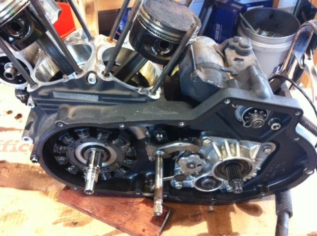

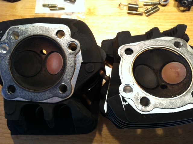

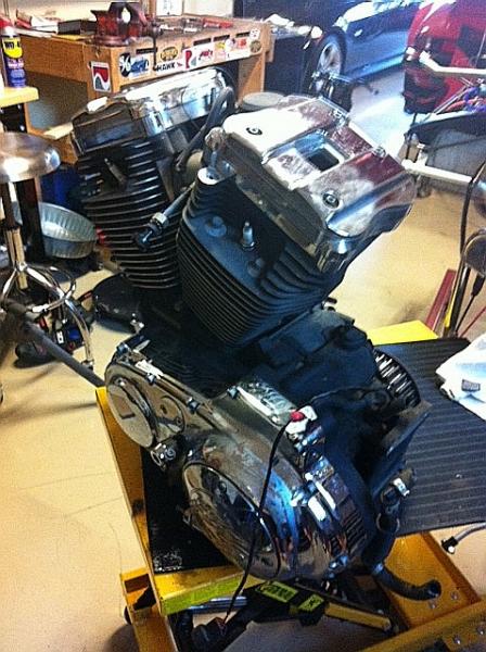

more pics
I found an old school peanut tank for it and a fat bob fender. Now I'm working on getting rid of the chrome, rust and dirt.
The cylinders were so outta round from the factory that the rings never seated and most all of the original cross hatch is still visible even after 13,000 miles! I'll be selling those 1200 P/Cs off and replacing with a nice set of aftermkt 1250 jugs.
Attached Thumbnails 1999 Sporty Chop/Cut/Rebuild-04-05-12-fat-bob-fender.jpg   1999 Sporty Chop/Cut/Rebuild-04-05-12-motor-tear-down.jpg   1999 Sporty Chop/Cut/Rebuild-04-05-12-peanut-tank.jpg

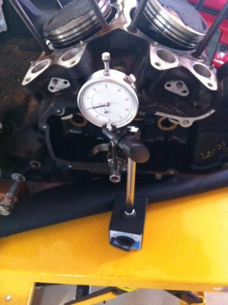

Crankshaft run out & end play
End play & run out are well within spec, so I'll split the cases tonight and give everything a good cleaning and relubing and start putting this puzzle back together
Attached Thumbnails 1999 Sporty Chop/Cut/Rebuild-04-06-12-runout-endplay-checked.jpg

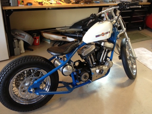

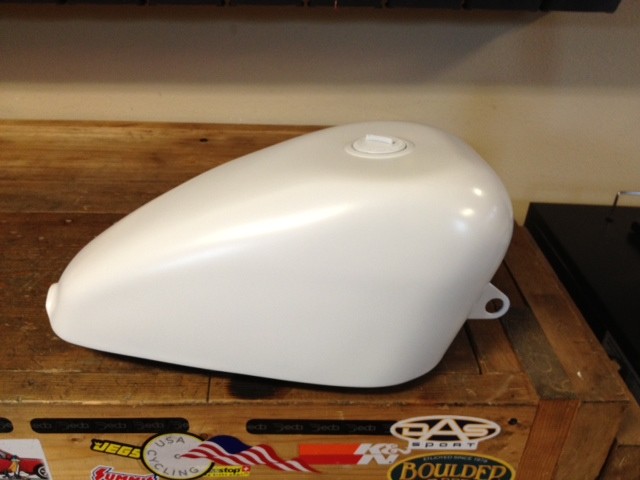

Peanut Tank Painted
I laid the base color on the tank and it looks pretty good. It's a Porsche paint called Grand Prix White from 1981. I like the fact that the white is not real bright. I had no idea how it would turn out, but it will work well as part of the old school Martini Racing color scheme and the theme for this build.
Attached Thumbnails 1999 Sporty Chop/Cut/Rebuild-04-24-12-peanut-tank-painted-white.jpg

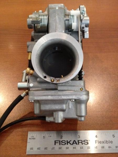

New Mikuni HSR42 Flatside
Well looky what came in the mail today
I'm replacing that old tired 13 year old stock CV40 carb with a big dawg that will get me over 100hp...yep you heard me right that's 100hp on a Sportster, but that's not where the fun is...the fun will be the 90 Ft-Lb of torque

Looks like a Mikuni HSR series...maybe a 42mm? I sure had a lot of "fun" trying to get that working properly on my turbo'd bandit, but should work famously on your sporty project.

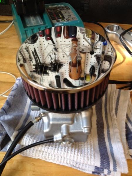

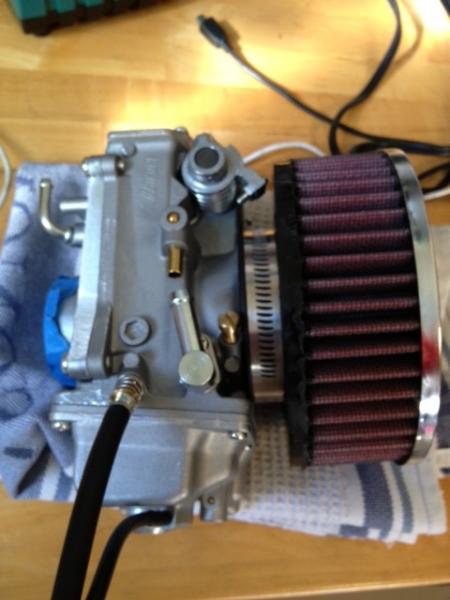

K&N on the Mikuni
Yep, that's the one and here's some pics of the K&N I'm running on it:
Attached Thumbnails 1999 Sporty Chop/Cut/Rebuild-04-26-12-mikuni-k-n.jpg   1999 Sporty Chop/Cut/Rebuild-04-26-12-mikuni-k-n-side-view.jpg

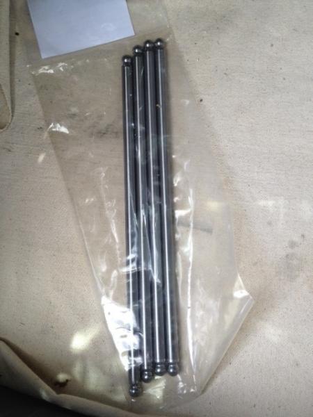

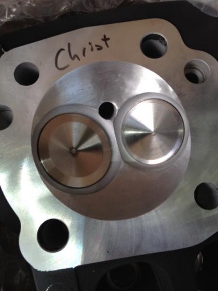

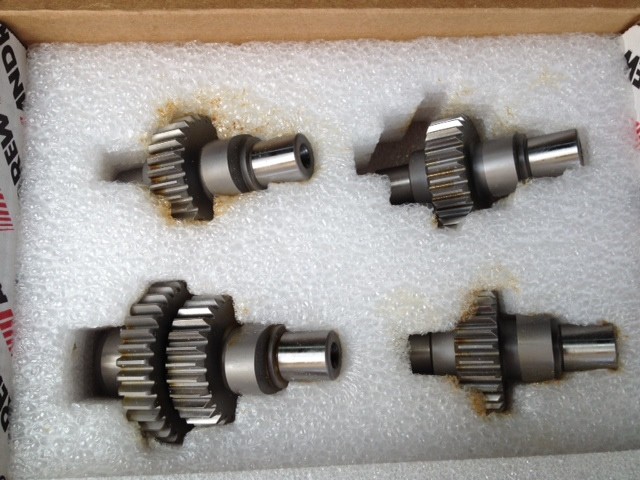

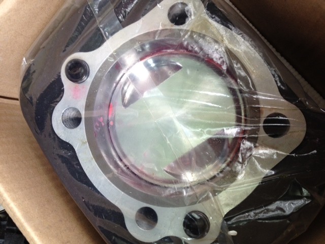

motor parts are in
Motor parts are in from NRHS:
1250 PCs
custom pushrods
STG2 ported heads

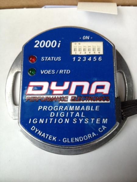

oversized valves
Dyna 2000 ign
Andrews N4 cams
This motor should pull like a train
Attached Thumbnails 1999 Sporty Chop/Cut/Rebuild-05-01-12-andrews-n4-cam-.jpg   1999 Sporty Chop/Cut/Rebuild-05-01-12-custom-pushrods.jpg   1999 Sporty Chop/Cut/Rebuild-05-01-12-dyna-ign.jpg   1999 Sporty Chop/Cut/Rebuild-05-01-12-oversized-valves.jpg   1999 Sporty Chop/Cut/Rebuild-05-01-12-pcs-1250.jpg

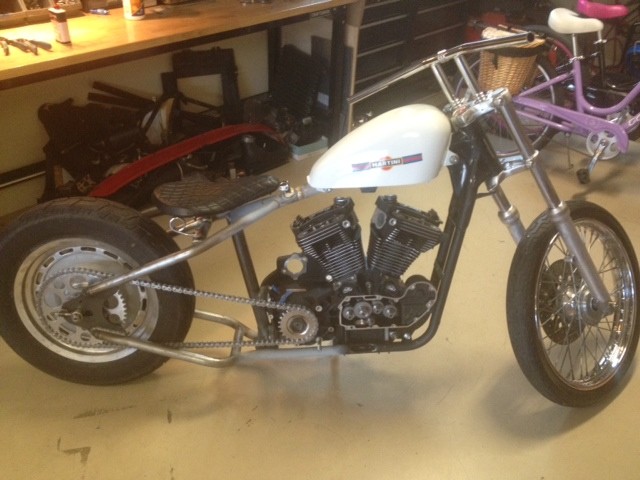

progress
Chain line looks good!
Attached Thumbnails 1999 Sporty Chop/Cut/Rebuild-06-12-12-chainline.jpg

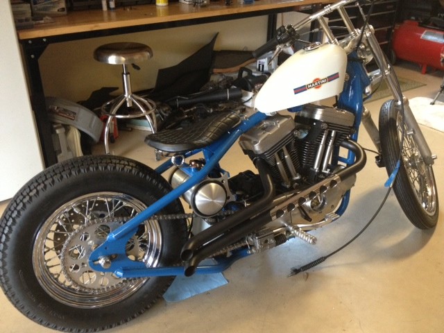

Reassembly started!
The best thing about finishing the painting is reassembly!
Attached Thumbnails 1999 Sporty Chop/Cut/Rebuild-09-24-12-assembly-update.jpg
Old Sep 25, 2012 | 12:40 PM
Damn, that thing sure turned out pretty good! I would LOVE to ride that around town! Good job man.

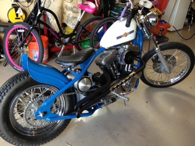

Old Oct 15, 2012 | 07:32 AM
FL02SupaHawk996's Avatar
Fastest Color
Posts: 2,091
From: Lithia, FL

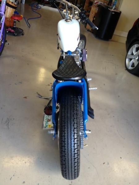

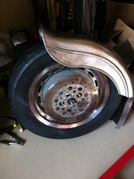

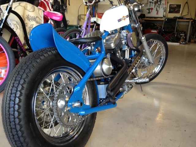

Fender is on!
More progress:
Attached Thumbnails 1999 Sporty Chop/Cut/Rebuild-10-15-12-rear-view.jpg   1999 Sporty Chop/Cut/Rebuild-10-15-12-rear-side-view.jpg   1999 Sporty Chop/Cut/Rebuild-10-15-12-side-view.jpg
