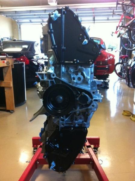

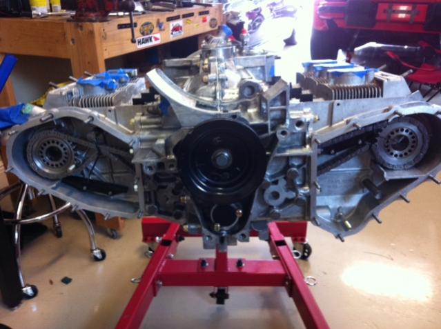

Cam Chain Housings
Today I bolted the two cam chain housings onto the case.

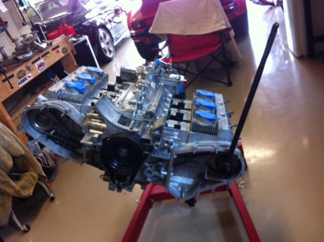

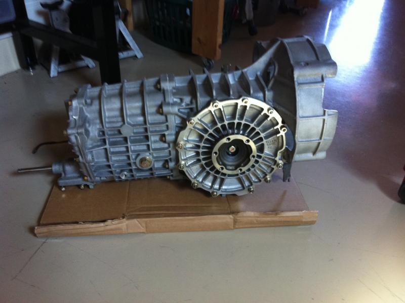

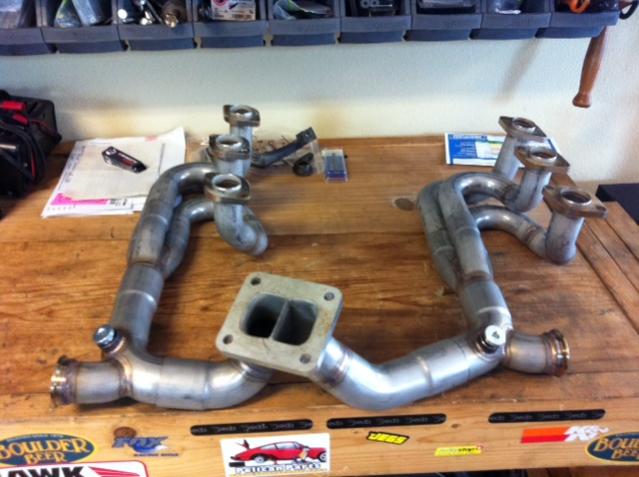

more progress pics

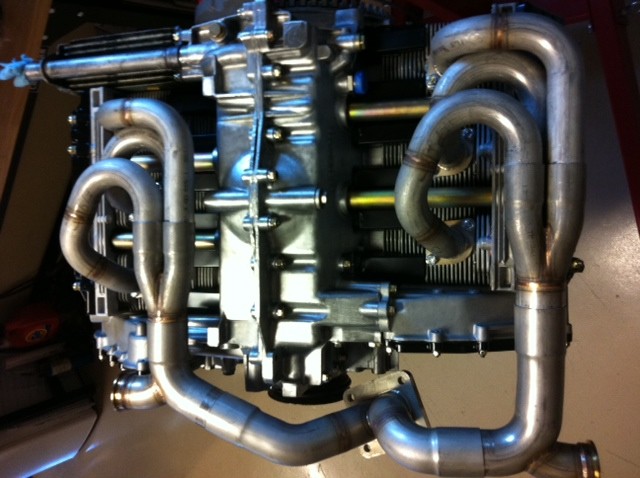

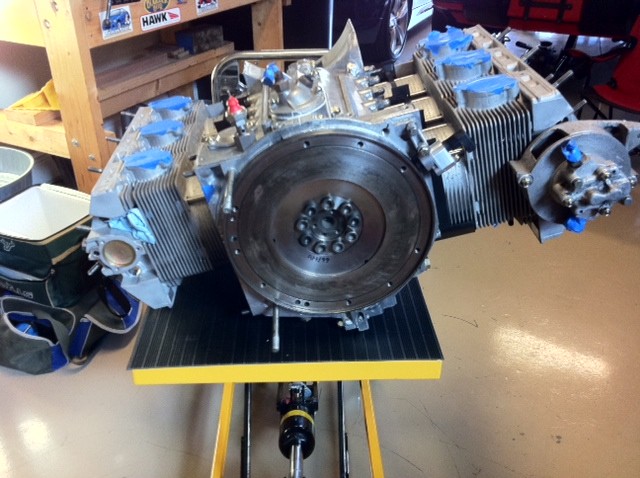

Tranny & headers are done and cam chain sprockets torqued...check out these sweet headers I had fabbed up
Attached Thumbnails Turbo Cage Build-08-27-11-headers-complete.jpg   Turbo Cage Build-08-27-11-tranmission-complete.jpg   Turbo Cage Build-08-27-11-chain-sprockets-torqued.jpg

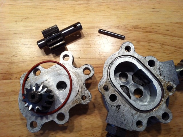

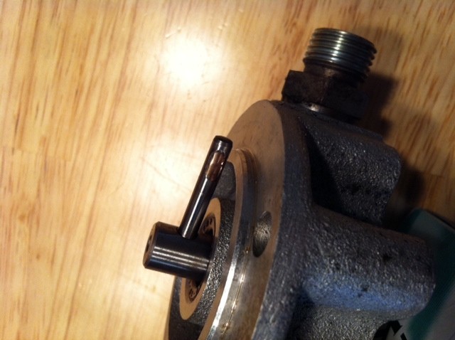

rebuilding secondary oil pump that feeds turbo
2 new seals, an o-ring and a new dowel pin and she will be as good as new!
Attached Thumbnails Turbo Cage Build-08-29-11-turbo-oil-pump.jpg   Turbo Cage Build-08-29-11-turbo-oil-pump2.jpg

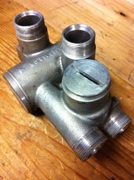

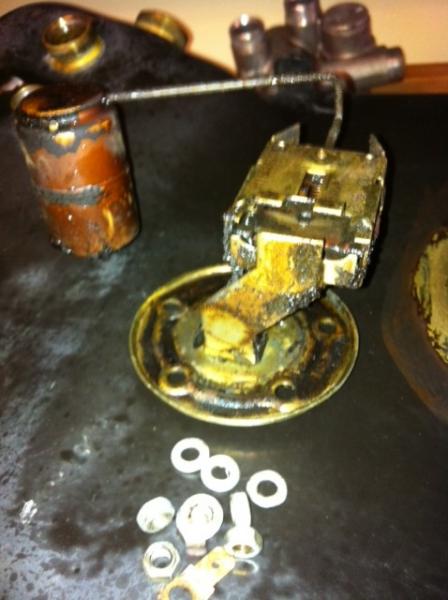

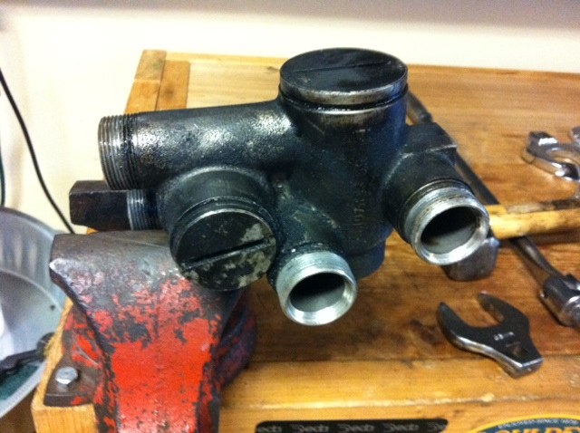

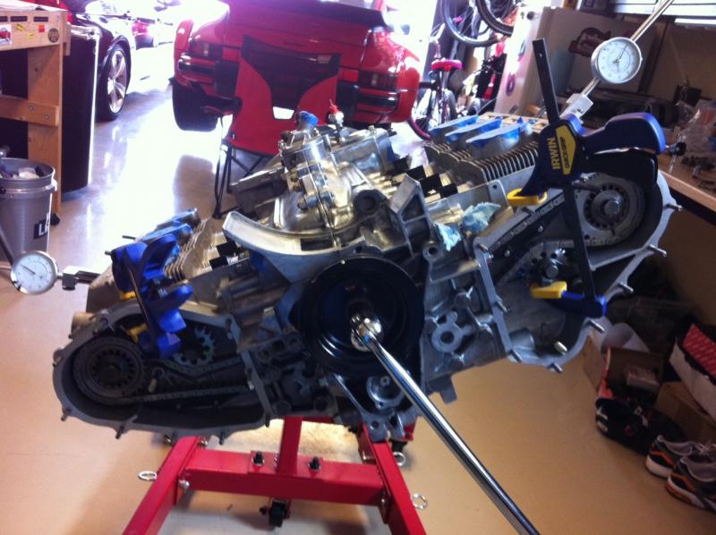

Cams timed and f'wrd oil cooler thermo out
Long weekends are great for my projects! I got the cams timed and pulled the front oil cooler lines off the thermo to clean it up and rebuild it.
Attached Thumbnails Turbo Cage Build-09-06-11-cams-timed-2.00mm-overlap-1-4-int-valves.jpg   Turbo Cage Build-09-07-11-dirty-thermo.jpg   Turbo Cage Build-09-07-11-clean-thermo.jpg

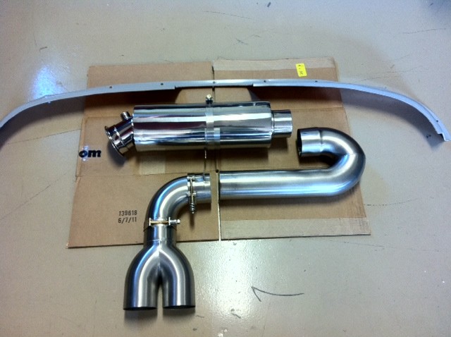

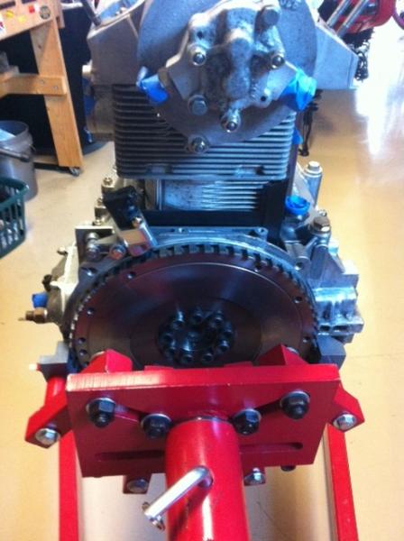

more progess

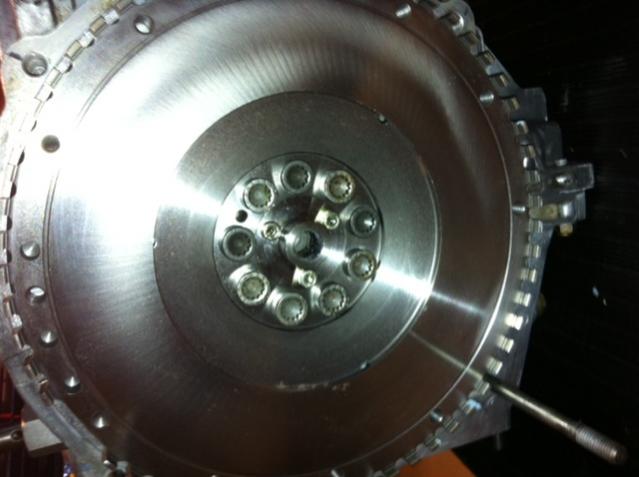

slowly but sherly
Attached Thumbnails Turbo Cage Build-09-19-11-rarlyl8-gt3-muffler-setup.jpg   Turbo Cage Build-09-20-11-964-flywheel-sensor-back-stand.jpg   Turbo Cage Build-09-20-11-chain-house-covers-.jpg   Turbo Cage Build-09-20-11-motor-xfer-stand-table3.jpg

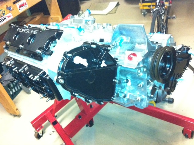

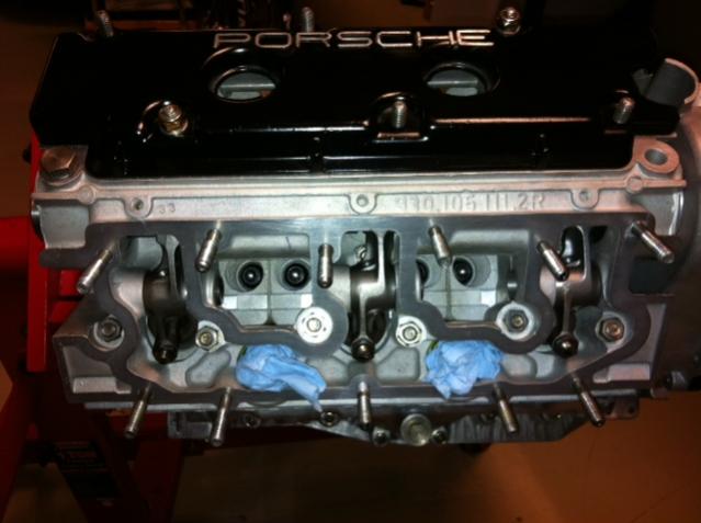

pilot brg torqued and left side rockers on
one more side of rockers to go and I'll seal this long block up finally!!!
Attached Thumbnails Turbo Cage Build-09-21-11-pilot-brg-torqued-greased.jpg   Turbo Cage Build-09-21-11-left-side-rockers-done.jpg   Turbo Cage Build-09-21-11-left-side-covers-.jpg

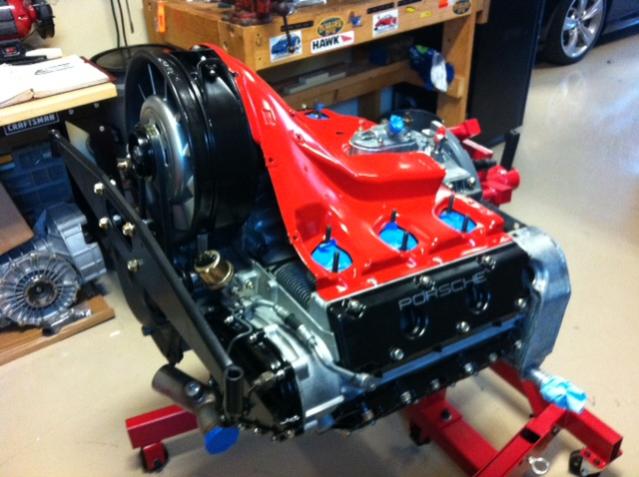

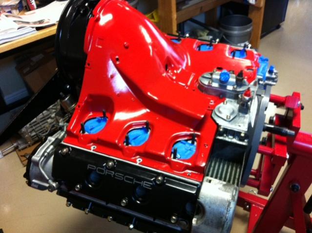

more progess & more pics

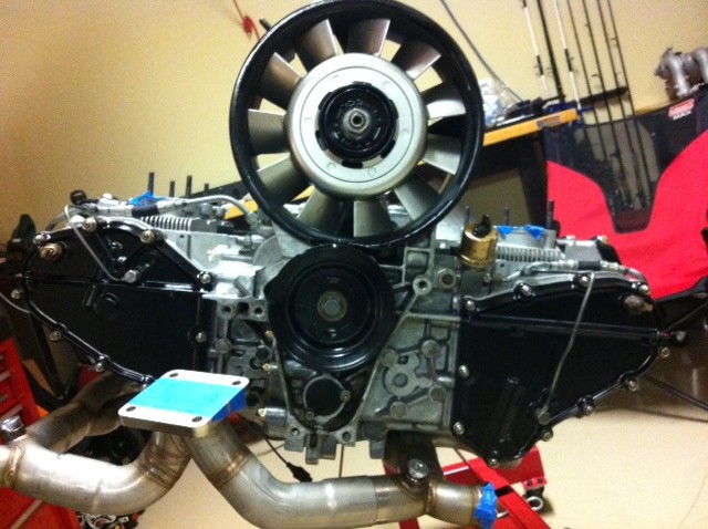

Headers fitted and fan mounted
Attached Thumbnails Turbo Cage Build-10-04-11-fan-.jpg   Turbo Cage Build-10-04-11-headers-.jpg

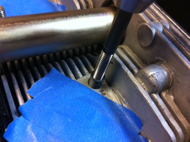

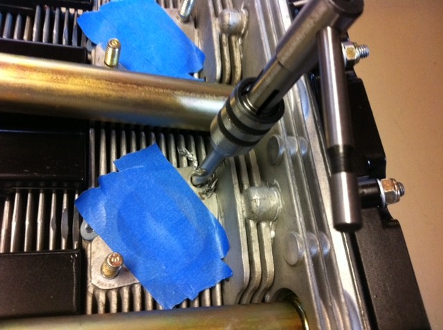

exh stud hole repair
had to fix another hole where threads gave out
Attached Thumbnails Turbo Cage Build-10-13-11-time-sert-exh-stud-hole-repair.jpg   Turbo Cage Build-10-13-11-time-sert-exh-stud-hole-repair2.jpg

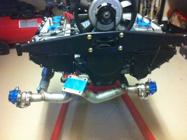

wastegates installed
2 TiAL 38mm WGs set at 0.7 Bar

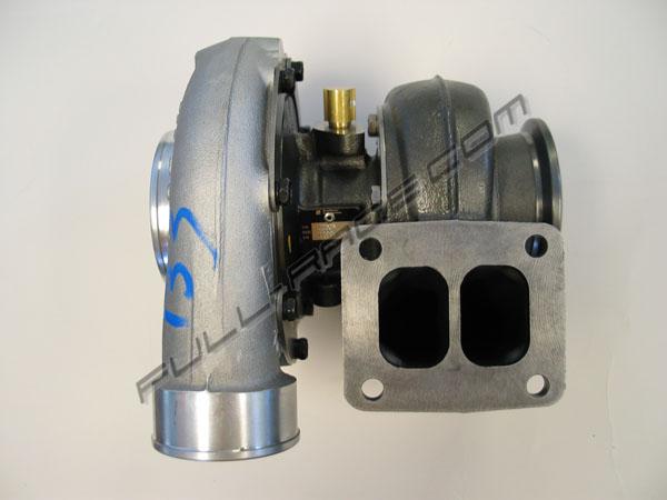

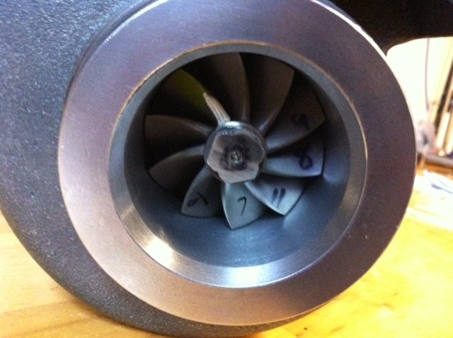

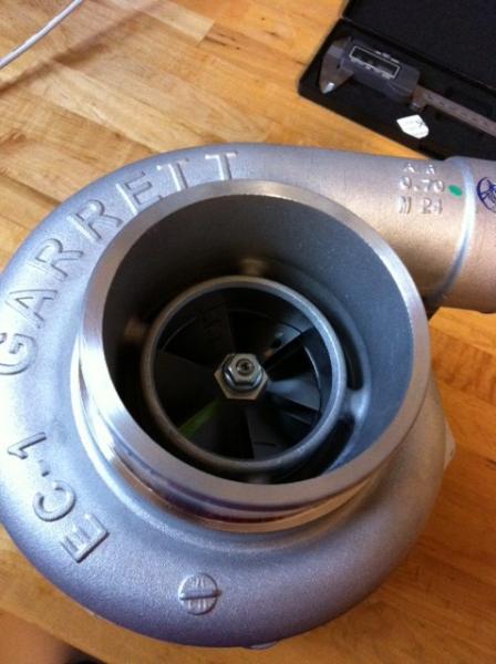

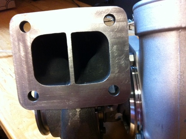

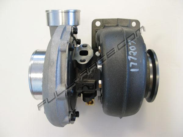

New Turbo came in
I had initially ordered a nice Borg but after waiting months for it to arrive I switched my order over to a Garrett GT3582R T4 twin scroll ported cold side shroud and happy I did cuz it's a real nice unit.

Originally Posted by mertechperformance
NICE twin scroll
Thanks
It's supposed to be good for 700hp, so I've got my twin waste gates set at 0.7 Bar or around 10 PSI of boost so I can sneak up on it
