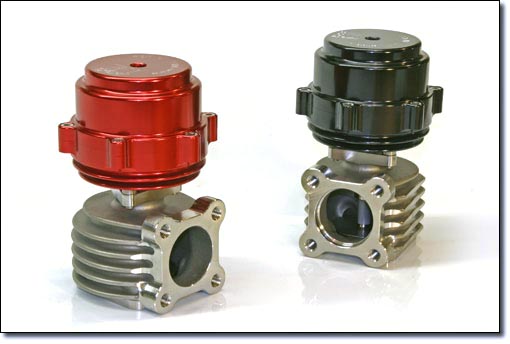

Waste Gate
Here's what the purdy one looks like

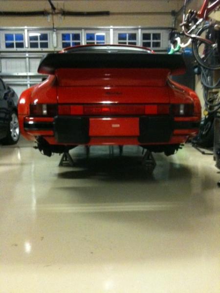

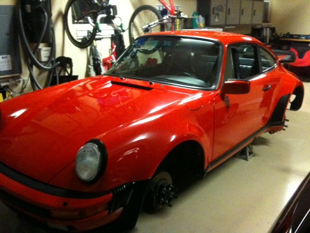

Up on jack stands
Last night I got her up on jack stands and started accessing the brakes. Looks like I'll need new pads for all 4 corners and rotors turned. I'm thinking SS brake lines are in order too...
Maybe I'll go crazy and powder coat the calipers...maybe not
Attached Thumbnails Turbo Cage Build-jack-stands-right-side2.jpg   Turbo Cage Build-jack-stands-rear-end.jpg

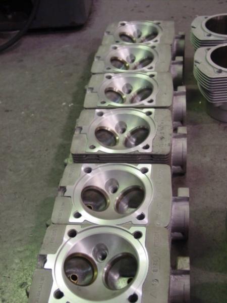

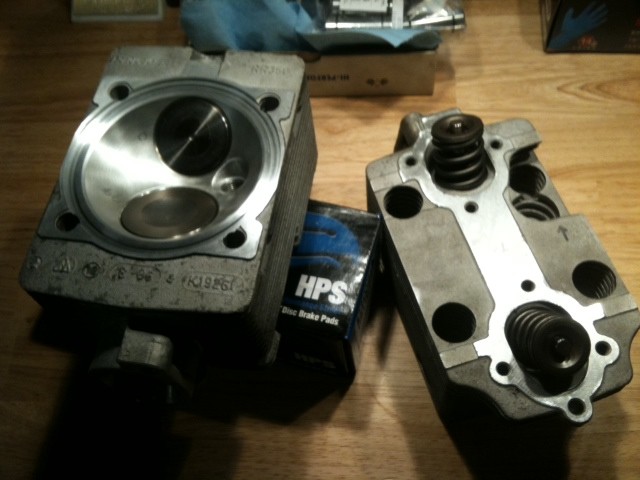

Heads
Here's a pic of the heads after they were skinned in preparation for fire rings
Attached Thumbnails Turbo Cage Build-heads-skimmed.jpg   Turbo Cage Build-heads-skimmed2.jpg
always looks nice. I'd be more interested in replacing/updating all the suspension bushings. what does it have for suspension now or all stock? is the car pretty original?
I agree and yes it's mostly original with Bilsteins on all 4 corners.
I'm starting with the hubs and brakes and will work my way through it slowly but surly

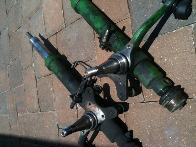

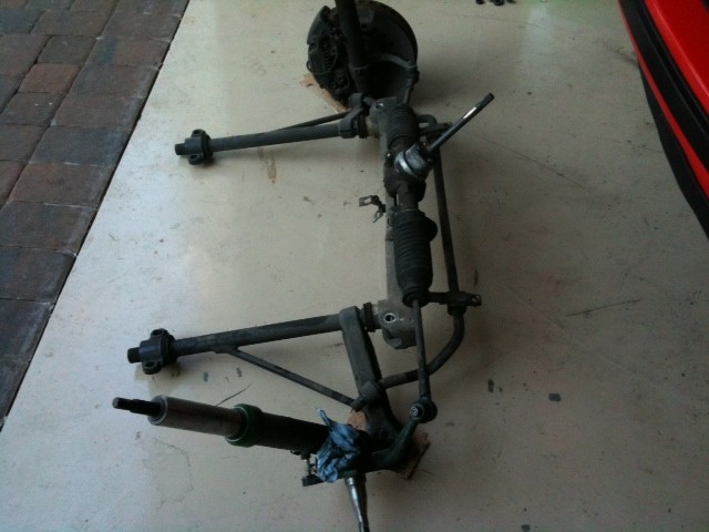

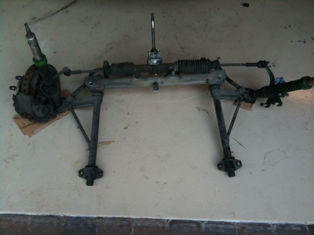

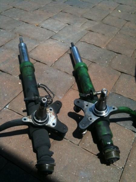

dropped front end
I made more progress this weekend rebuilding brakes & front end
Attached Thumbnails Turbo Cage Build-front-end.jpg   Turbo Cage Build-front-end2.jpg

struts
replacing strut inserts, brgs, ball joints, discs, pads, top plate, boots, etc...should be as tight as new when I'm done
Attached Thumbnails Turbo Cage Build-struts.jpg   Turbo Cage Build-struts2.jpg

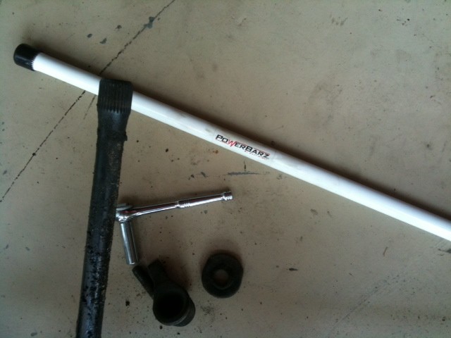

Bigger Torsion Bars
The stock Tbars were 19mm thick and the new ones are 23mm

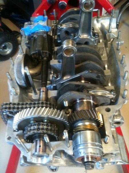

crank fit test

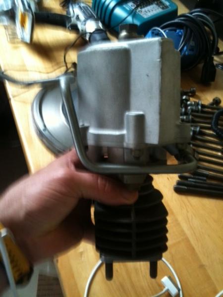

while waiting for a couple of parts I fit tested the crank & intermediate shaft in the right side case and fixin to start on the heads
Attached Thumbnails Turbo Cage Build-crank-fit-test.jpg   Turbo Cage Build-head-assembled.jpg   Turbo Cage Build-exh-valve.jpg   Turbo Cage Build-int-valve.jpg

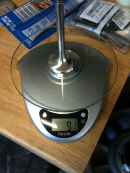

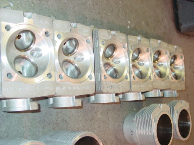

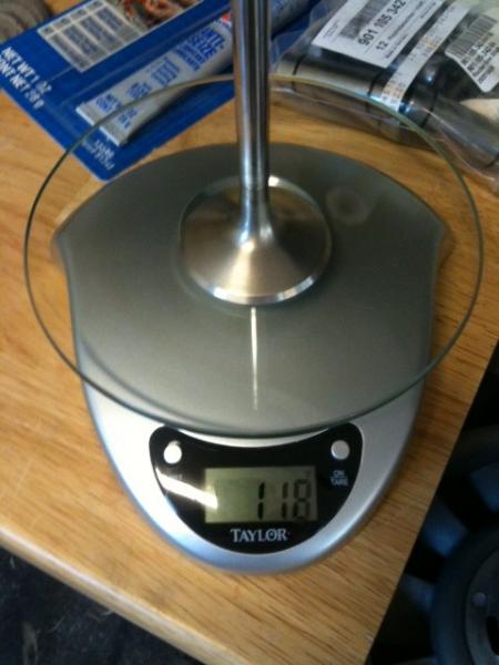

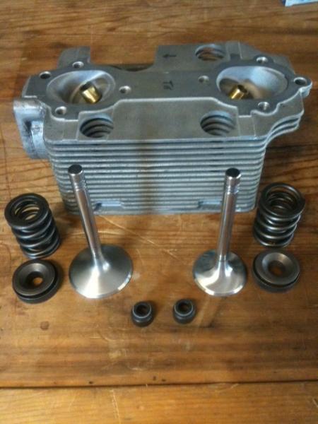

Heads getting assembled
2 heads down and 4 more to go...if I were building a SH I'd be done with the heads by now!
here's two tricks that my help when you're building up your heads:
1- put some assembly lube on the valve stem in the keeper groves so when you get a keeper on the stem it will stay and not fall off when you hit it with the second keeper
2- put some Dow Corning pure silicone grease on the valve stem seal to insure a nice seal. I use the end of a fat sharpie to dip in the grease then run it around in the seal. She'll be air/oil tight fosho then
RC

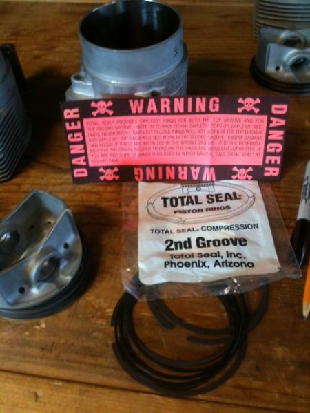

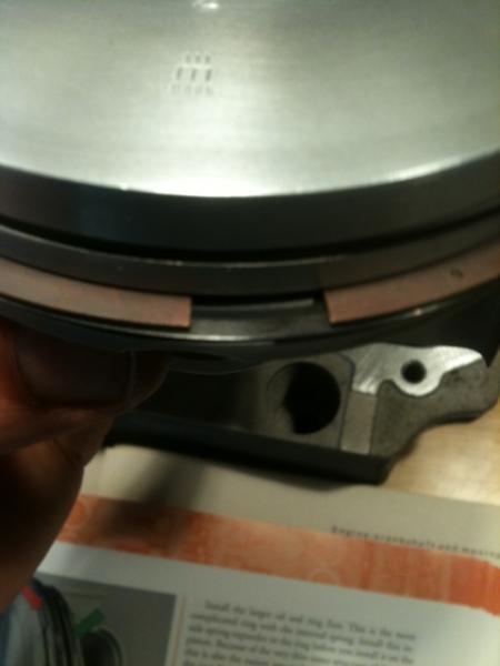

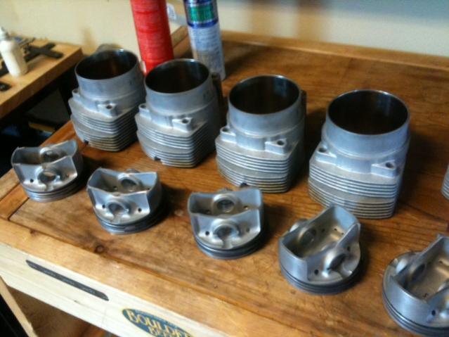

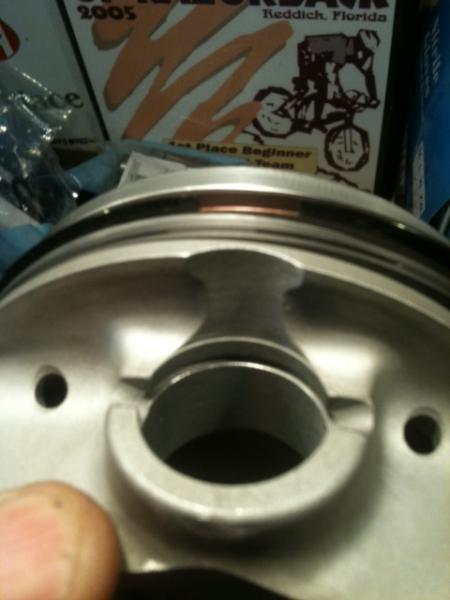

Movin on...heads done ring gaps next
Tonight I got 3 slugs ringed and using a gapless ring in the second CR groove to improve the seal...
Attached Thumbnails Turbo Cage Build-gapless-cr2-topside.jpg   Turbo Cage Build-gapless-cr2-bottomside.jpg   Turbo Cage Build-total-seal-cr2-gapless-warning.jpg   Turbo Cage Build-final-ring-gap-check.jpg   Turbo Cage Build-ringed-slug-weight.jpg

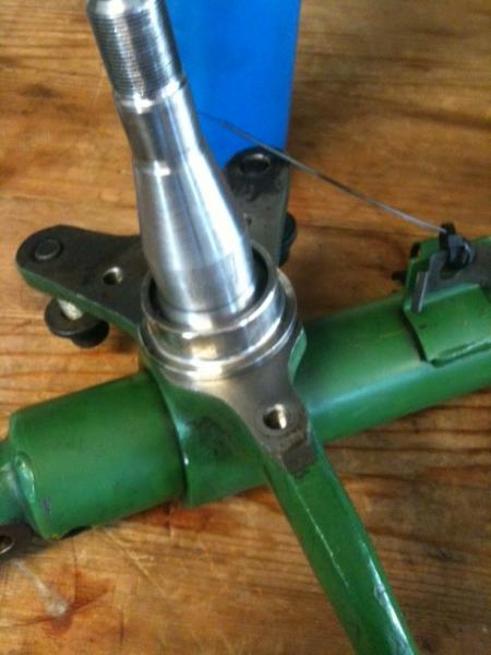

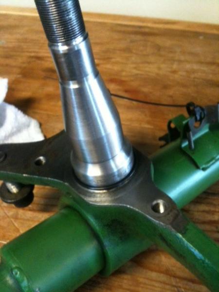

Progress this weekend

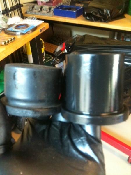

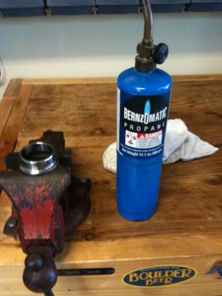

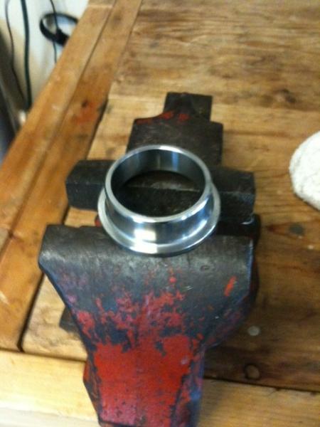

Waiting for some o-rings before I can close up the motor, so working on front end this weekend, added a missing spacer on one of the spindles, replaced all A-arm and sway bar bushings, removed and ordered all new wheel bearings, ball joints and control arm joints. Once I get all the new bits on including the upgraded strut inserts the front end should be tighter then when she rolled outta the factory 24 years ago!
Attached Thumbnails Turbo Cage Build-spacer-missing.jpg   Turbo Cage Build-spacer-ready-go.jpg   Turbo Cage Build-spacer-tourch.jpg   Turbo Cage Build-spacer-installed.jpg   Turbo Cage Build-arm-bushing-new-vs-old.jpg

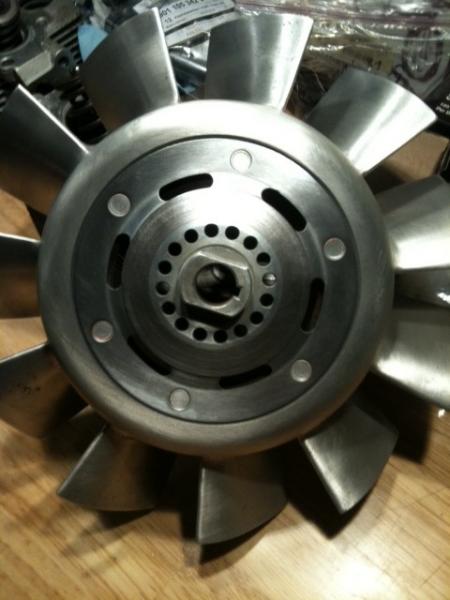

Magnesium Fan
Anybody know a good paint that likes to stick to magnesium?
Old Jun 14, 2011 | 01:30 PM
  #54
zmaniv's Avatar
Posts: 916
From: San Diego
Why would you want to paint that beautiful looking fan?
Old Jun 14, 2011 | 01:37 PM
  #55
FL02SupaHawk996's Avatar
Fastest Color
Posts: 2,091
From: Lithia, FL
Cuz it will oxidize to a dirty grey color
Old Jun 14, 2011 | 02:33 PM
  #56
zmaniv's Avatar
Posts: 916
From: San Diego
Then clear coat it
Old Jun 14, 2011 | 02:50 PM
  #57
Fastest Color
Posts: 2,091
From: Lithia, FL
Then clear coat it
I have considered it but worries it wouldn't holed up as well as an enamel or epoxy paint
