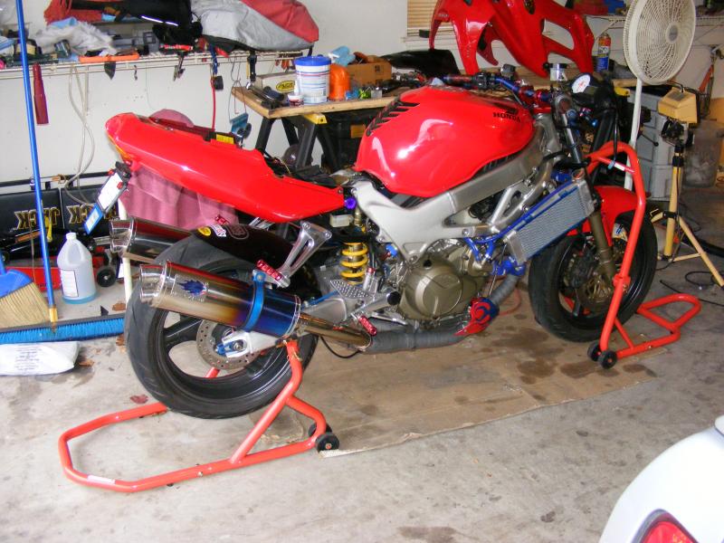

Changed all my hoses during last yrs. annual maintenance. Went with the Samco hoses, not only for the bling, but because they are silicone. Guess I'm a bit **** here because of the buisness I'm in is all about preventive maintenance. I've seen hosed on generators last over 10-15 yrs. that looked & felt ok, but blew when needed most. When I ordered the Samcos it took almost a month due to backorder.
