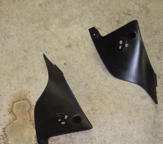

what are these and where do they go?

in a box of parts that i got from the PO and was wondering (since the bike is all tore down) what they are and if i should put them back where ever they go!
They are the somewhat faux radiator air intake scoops that attach to the inside of each side of the front fairing assembly. I would reinstall them.

Inner fairings, not faux intake scoops. These should be reinstalled, though the only fuction that they really have it to hold the turn signals and wire loom. They might also smooth the airflow a bit and make the bike look better from the front.
Call them what you want but I don't recall any wire loom in there but one could I guess. I don't run the OEM TS/RLs (I like the LP Type 3s) but I bolted to inside of them the tubes that project out front thru the nostrils to which my driving lights mount (see attached sketches).

I discovered on a very hot day, that those ducts work very well for directing cool, ambient air over your legs and keeping the hot radiator air to the outside. It was so firggin' hot, droning across the San Joaquin Valley one day on my way from the twisties to the other twisties, that I was riding with my gloves stashed. I was messing around with my clutch hand, when I noticed how much hot air was coming off the radiators, but next to my knee it was (relatively) cool, the same as the air temp.
I say keep the ducts! I used to stuff a rag in the inlet during the cold months to keep my legs warm. Worked great.
