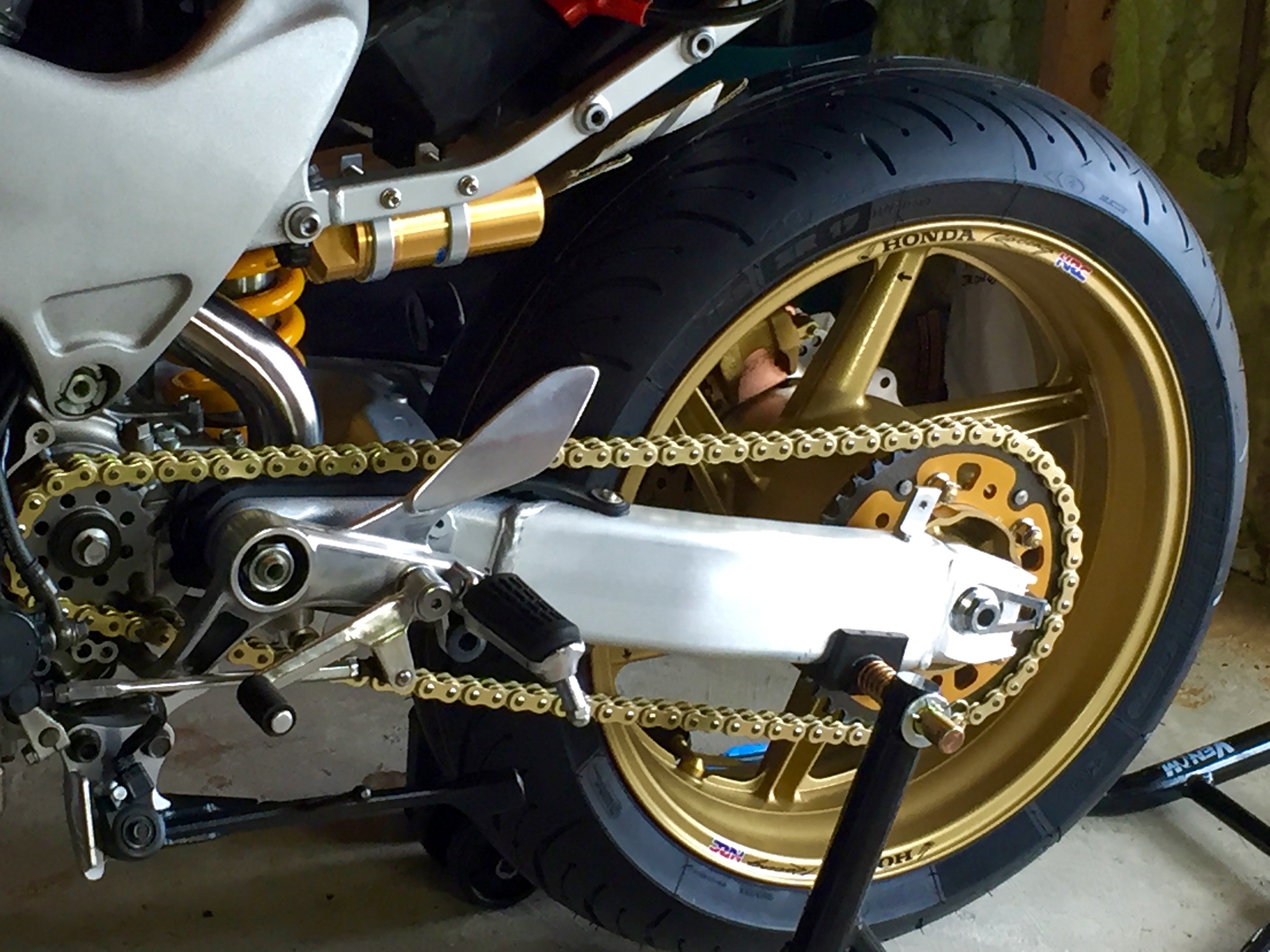

I doubt anyone has asked and search came up nil. When I bought my VTR I thought it had a few minor mods. I was mostly wrong. factory showa rear and nissin calipers. But I have a nice gold colored chain drive that looks and feels like anodized aluminum. The only part's I see that is after market for sure is my carbon fiber lower pan and stainless break lines. Ill take a shot of the sprocket tonight.
Also I am a light guy and pretty new to liter bikes. I have zero complaints about the
suspension. I never even touched it from the last guys.
With all of that said What might I have missed?
this bike out performs in all areas except for it seems like a bear to lean.
Put up lots of photos. will put up more if needed.

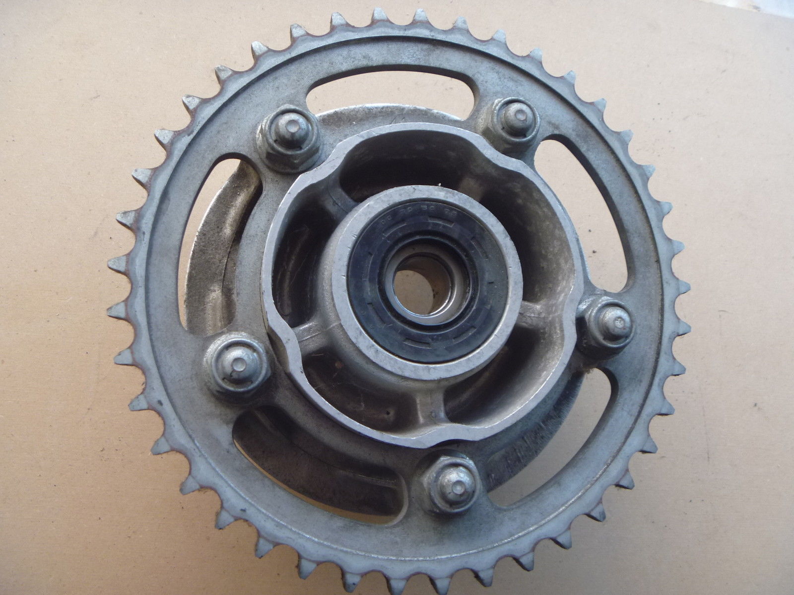

You mean the rear sprocket?
Might be a Stealth, which is a steel chainring aluminum carrier.
if the whole thing is aluminum, start looking for a replacement, it won't last long.
Is it like this?

I am new to bike ownership my friend. It looks like I was either wrong (most likley) or it has a thin ring of steel around something else. If thats the case I have never seen a sprocket like that.
A quick check for sprocket material would be to check it with a simple magnet. If it sticks, it is steel. If it doesn't stick, likely aluminum.

Assumed... IT's indeed anodized aluminum with steel gear teeth pressed discreetly into it. Is that stock!? the P/O took good care of it.

That is an all aluminum, gold anodized rear spocket, not stock, the teeth will be aluminum also. Only the SuperSprox sprocket has an aluminum carrier with a steel tooth weel riveted on, it is the one E. Marquez pictured. This one will wear quickly using it on the roads, great for a trackday or competition bike though. , I have attached a pic of the OEM style sprocket and a Supersprox mounted up on a wheel.
Attached Thumbnails What is factory and what isnt?-%24_57.jpg   What is factory and what isnt?-img_7895.jpg

Ill look at the brand in the morning. I am betting your right but I had the magnet stick to the teeth. May have been metal I didnt see. Its 2am here... I am betting this bike has a few subtle mods. Ill get balsy and take the tank off to clean the carbs. more photos then.
Old Aug 27, 2016 | 10:13 AM
If it is magnetic, it will be all steel and painted(powder coated?) gold.
If steel it will wear decently, if aluminum buy a replacement now, if you ride every day, by the time you get the new sprocket set that aluminum one will need replacement.

Pretty sure its aluminum. Probably wearing fast. looks like its starting to sharktooth from the hills. Im lucky enough that parts come next morning. More curious as to whats in my airbox. Ill get on those photos when im more awake.

You should get rid of that sprocket asap, or it will get rid of you. They wear out like a pencil eraser especially on this bike.
Get a steel one and you can forget it for thousands of miles. That one will be dangerous after a couple rides.

Titanium for a sprocket? Not that I have ever seen, and wear characteristics would be about the same as aluminum in that application.
Not a good material choice.
The simple and cheap answer is a steel sprocket..remember the longer you use that AL sprocket and it wears, the more it is wearing and damaging the chain, which will then require replacement at more $$$$.
Replace that sprocket BEFORE it is worn if you want to re use the chain.
The SuperSprox Stealth sprocket is the only lighter weight one I know of that will have good wear characteristics due to the steel chain ring.

If money or economy is a factor, just buy a steel one. The steel/ aluminum is exotic and best for racing where you really care about weight. On the street you don't. Its more for the bling factor and will be lost on most anyway.
I ride year round and my bike is my commuter vehicle in all weather so the last thing I will do is create a point of needless wear (as mentioned a worn sprocket is bad for you chain) so it is going to cost you more money.
Don't sleep on it. A new steel sprocket is cheap ($42 to you door)
Sunstar Sprocket Rear 41T 530 Steel for Honda VTR1000F Super Hawk 1998 2005 | eBay
