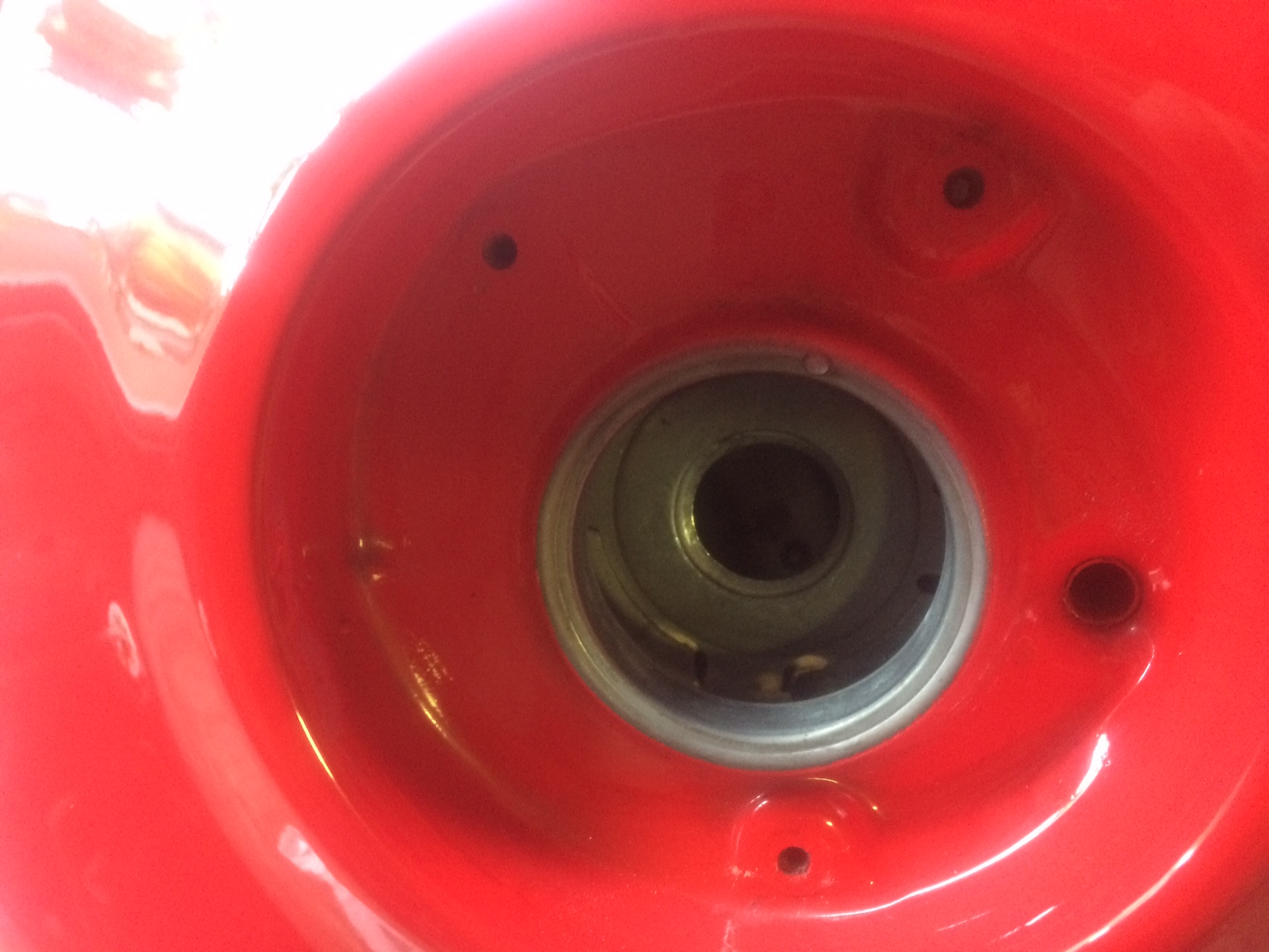

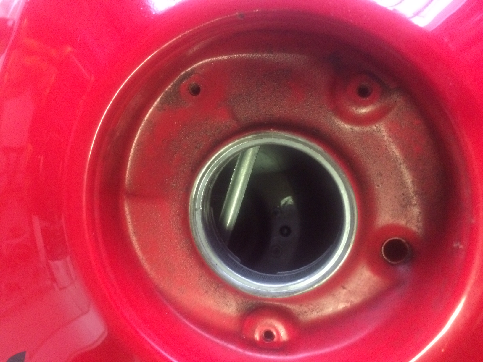

So I'm fixing up an '02 (U.S. model) I recently bought. Tank was dented and found a real nice tank in Greece (like I've said parts are getting harder to come by). Said it was off an '01, so either Greece didn't get the 19L tank or it's off an earlier year(not that I was even looking for one or that it was described as one). Think it might be off an earlier model though as it has the earlier style sending unit inside. Sooo... already read some real helpful info on here about swapping sending units (bending the float to 60 degrees, etc. so it'll fit). My question is regarding this restrictor plate thing in the tank, and do I leave it or remove it? I found online it might have to do with not allowing the use of leaded fuels with larger pumps (does that sound correct and is that it's only purpose?). Hoping it doesn't get in the way of the new sending unit. Thanks.

Impatient as I am I already ripped it out. Allowed me to see what I was doing with regards to bending the float to work. Who know how many internal variations Honda blessed us with but for what it's worth I had to bend the arm 90 degrees and 90 degrees back to effectively shorten it enough to clear the vent tube inside. Now that I can see inside it seems to move freely up and down through the full range of motion, so the gauge should read properly. Be a few weeks before I get back to this and filling it up to know for sure though.
If that was in the US, Yes Id say it was a unledded dispenser restrictor. As it came from Greece, I have no idea if such a thing was even done
Old Aug 23, 2016 | 03:05 AM
Some EU bikes had that, various sizes for the various fuels including diesel, to make it fool proof... Stupid and unnecessary IMHO...

I have the fuel tank off my '98, on my '05. I didn't have to bend the float as much as you have to clear the vent tube. And yes, it works just fine for me.

Yeah I had to end up bending a 90 degree "bus stop" into the arm to shorten it. It should be pretty accurate as it drops very near to the lowest part of the tank. I already deleted a curse filled rant on how the gas cap doesn't lock on this tank either (thanks to the wacky inner neck on the fill hole). Out of time and also patience with everything else going on in my life a nice new Chinese race cap is already on it's way. Problem solved.
