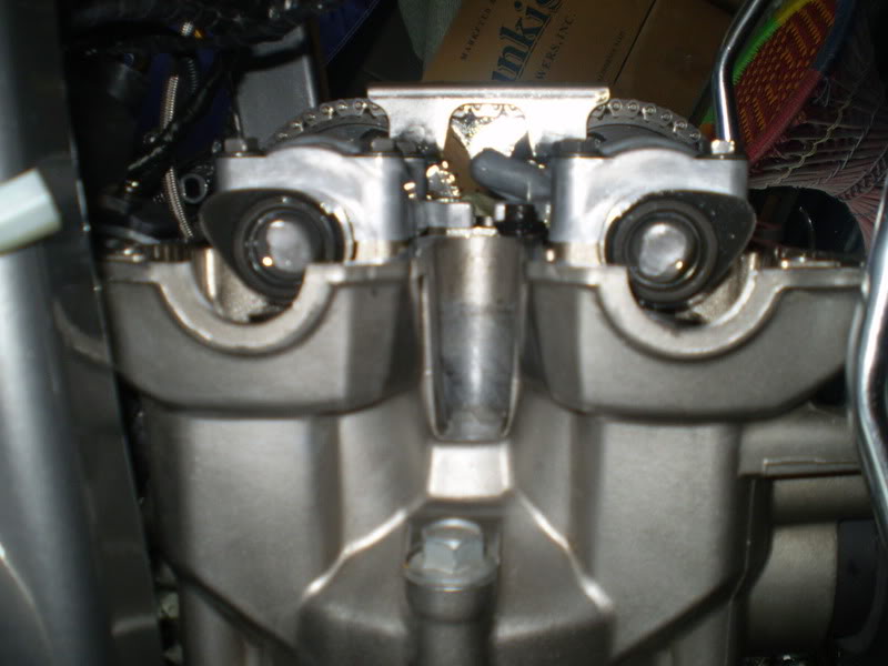

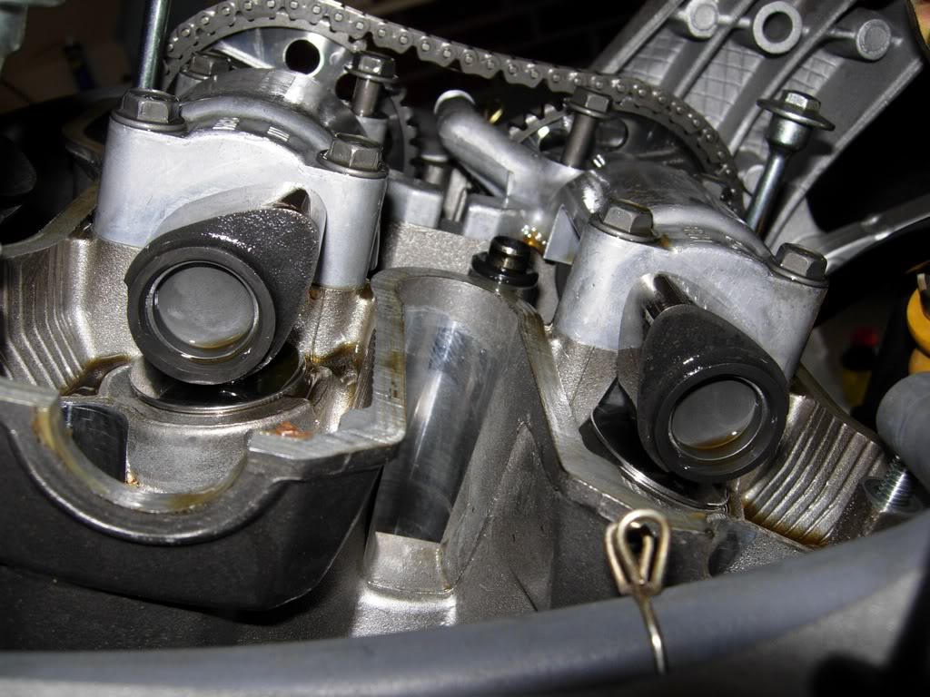

Seems like you got it right by the description... this stuff is really kinda confusing in words as the front and rear have the same procedure, but the alignment is slightly off.
The easiest way for me to tell is that the cam lobes are pointing out and upward when you're at TDC for the front, and up and indward when you're at TDC for the rear...
This is the front:

Rear (image was jacked from another thread):
