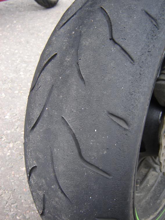

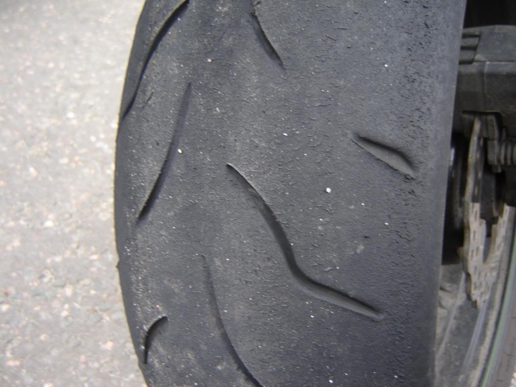

I did this on my 2009 zx10r on the road, suspension was perfesionly set up, but the theottle spent most of the time at the stop in the twisties, 1st 2nd and 3rd gear

You guys are doing a respectable job tearing up those tires. If I had some money to invest, I'd be puttin it into the tire companies.hahaha. I thought i was eatin mine up quickly, but you guys are making me look like a freakin slacker. Look like track tires. You're having way too much fun Sean. You need to get on the track and get some sponsers. hahaha

Naa, naa naah... You still have a visible chicken strip... Go out again and practice more...:rotfl:
Seriously though, nath is right... If you can run the pace to make a tire look like that with a zx10r on the street, you should get on a track... Much less moving obstacles to contend with...

acc to the guy i spoke with today, medium compound is the same, however it's the percentage of tread that's the difference, same as shown in their charts. I really don't believe he did anything but look at the charts we can see and spit back what we already know. if i find more I'll report.
Well, I can tell you from talking to one of the tech guys at Michelin here in Sweden that he's full of it... The rubber compound is completely different, it's not the same mixture in any way...
Now the actual hardness of the compound might be the same or at least very close, on medium vs medium, that I never asked, but I'm guessing that should be true...
BTW regarding your pressure... 28 is TOO LOW, your tire is eating itself... The guy told me that on most tracks he'd recommend 32-36 for the rear... On a few 30... Never below that... For street riding, he suggested adding around 4-6 psi ie high 30's to low 40's... I'm running 40 rear now and 35 front... A bit lower than the spec sheet recommendation, but seems to work...
