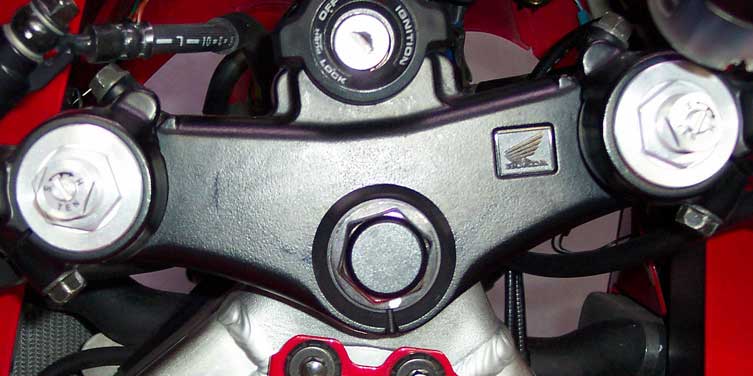

The more I think about it, I will probably put money into my suspenche before I put it into much of anything else. Makes alot of sense to me. But anything will be an improvement since the last owner has these settings on the front. Can anyone tell me whats wrong in this picture?

Did anyone catch the settings shown in my photo by the way? Am I correct in thinking both sides should be symmetrical as opposed to... well, opposed? Take a close look at both sets of adjustment ***** and tell me if I am nuts.

And all is well in my photo up there that I was so worried about... I downloaded a manual and I see whats going on.
