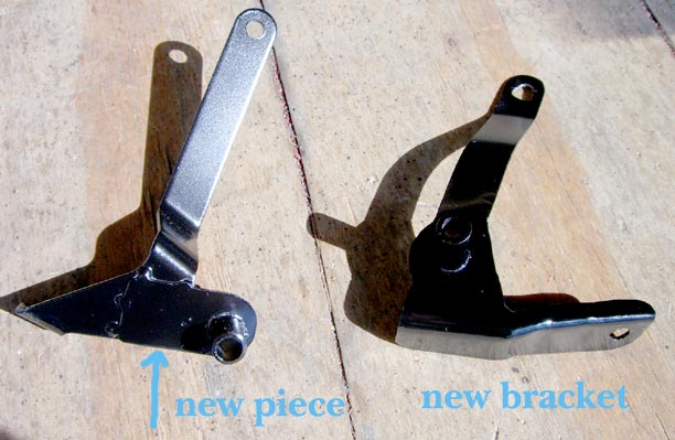

Gregw... Did you grind off the backside of the steering stops on the lower triple? otherwise they hit the mount for the front fairing stay before the stops, making it tight... Also needs to move back the rads a tad...

Thanks for reminding me. Yes and yes. I moved the rads back 7/8" and rotated the top radiator hose 90° or so. Yesterday I worked on the lower brackets for the rads and fairing. I was able to use most of the left bracket, just adding a new tab and tube. The right side needed to be made from scratch though since the fan shroud was getting in the way. Not my best work, but no one will see them.
