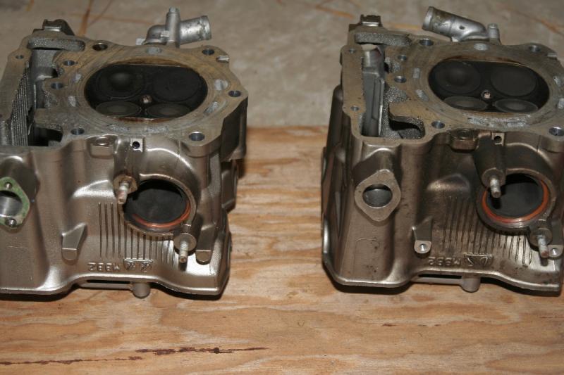

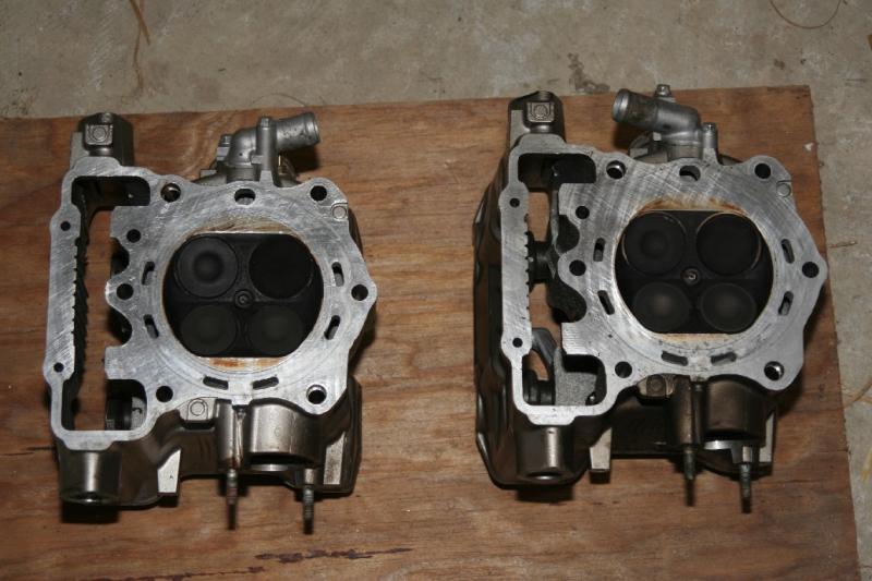

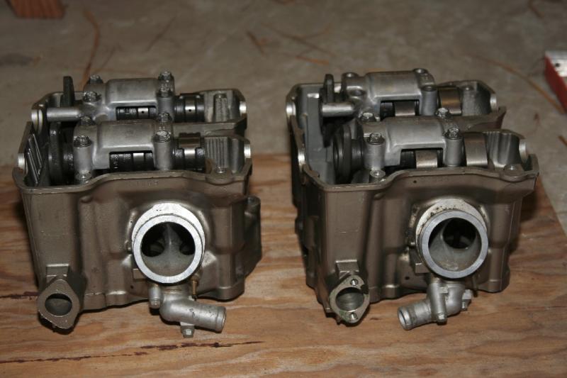

Attached Thumbnails Front head, Can I use a rear head-img_0286.jpg   Front head, Can I use a rear head-img_0289.jpg   Front head, Can I use a rear head-img_0290.jpg
Old Aug 14, 2012 | 03:50 PM
Other than the differences already mentioned, I think the two heads are identical.
The difference being:
Machining of the CCT mount.
Use of a differnt water neck,, but it is removable so not an issue.
So we are talking the need to block an old CCT mount, and machine the unused one.....
Hmmmm
Not bolt on, but very doable if needed.

Ok so I have the new head.. took measurements, and many pictures.. so the difference to sum up what has already been mentioned.
CCT mount need all 3 holes fixed.. center enlarged and punched through and the two side screw holes drilled and tapped.. but you also have to face the CCT fitting as it's too rough to seal.. easy on a millling machine but don't try with a drill press.
on the other side is the mount for the fairing this will need to be drilled and tapped as well.. other then that I see no reason that this would not work.. might take a couple hours in a shop to complete.
the large hose fittings turn 180° and fit perfect.. the small hose can be fitted by removing a screw that plugs the hole and screwing in the fitting from the front head.
here is the comparison pics
