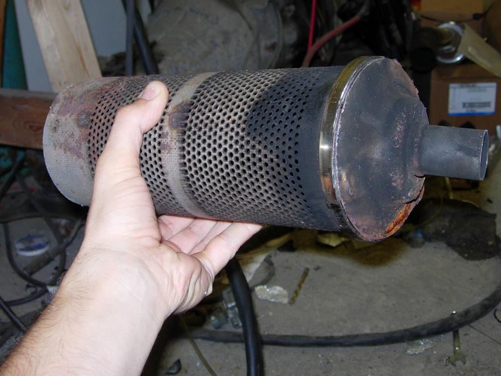

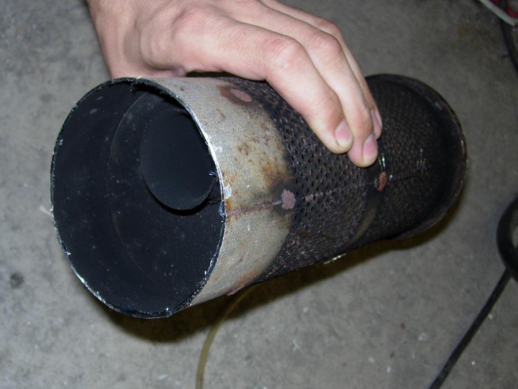

it can be done cut it with a thin disc. If you are looking to copy an aftermarket exhaust design you can copy what I did. I cut the end of the can off and I cut the lower end off too. Then I hammered everything that lived inside out, this left just the outer tube. I then made a perforated core tube I ben by hand surrounded it tightly with exhaust packing ($15) or so from the parts store. Then welded in two pieces of tubing slightly larger then the perf tube on each of the ends and welded it back together. Now it is just like an aftermarket exhaust but for less then $25 sounds the same as aftermarket and weighs the same as well. Just my 2 cents, also I posted a thread on is somewhere, I will look.

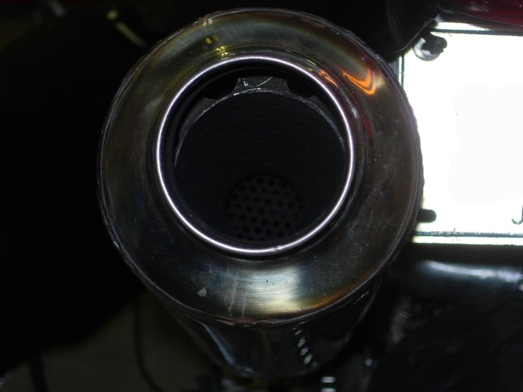

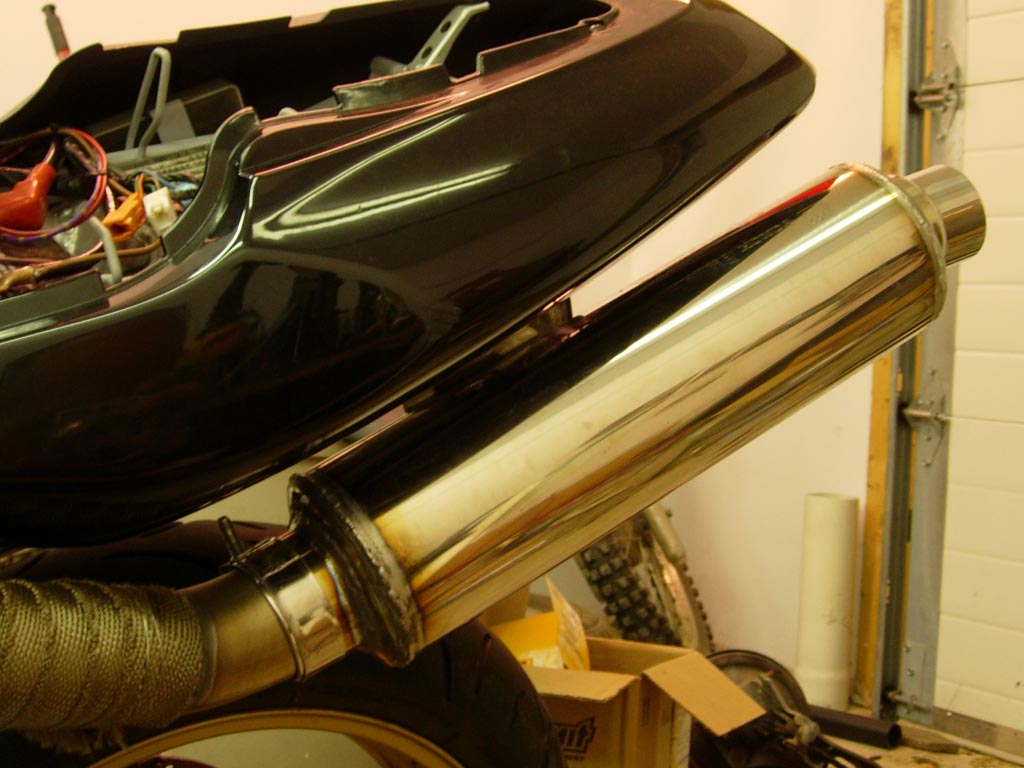

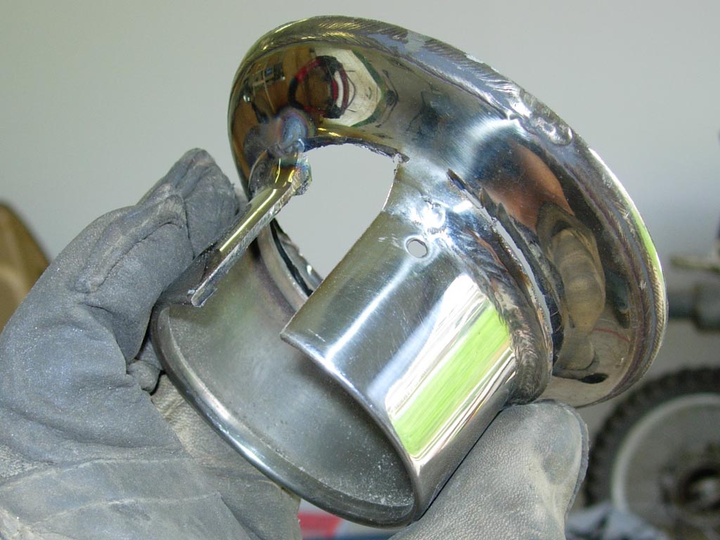

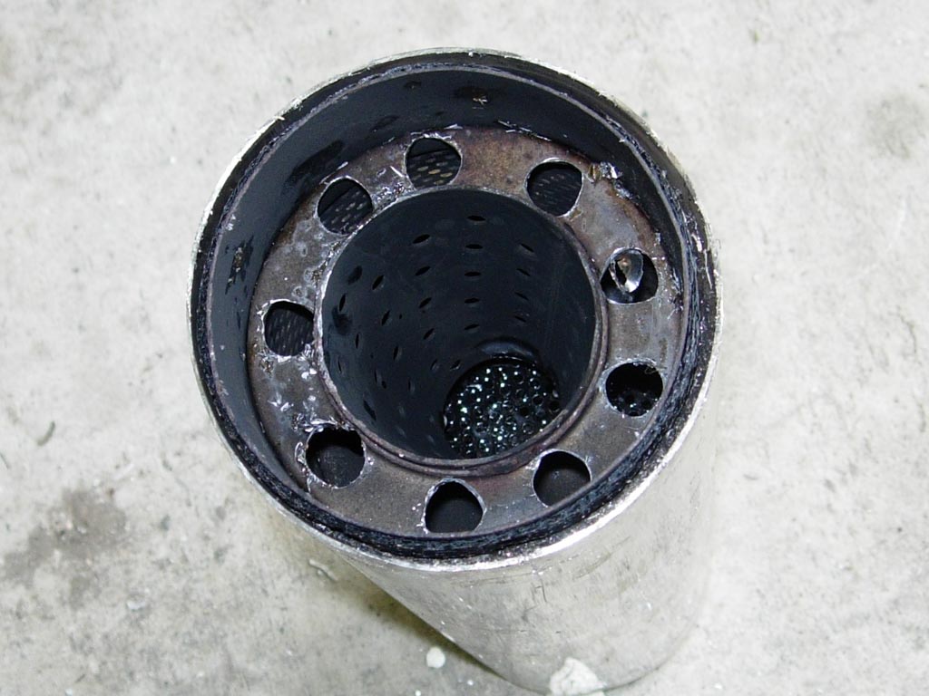

I used the two outlet tips as in and out, I have cut it with a cutting disk, the inside will slide out, there is a packing glass between the perforated 3 chamber chicane and the stainless shell, the insides are very heavy.
I have cut the first chamber and screwed it at the very back using the screen to damp the pulses and have drilled holes around for flow. The cops here measure the depth of the inside tube so it saves me tickets as well.
Unfortunately it's still too loud for me so I will get a perforated tube, weld it on the center axis and pack the outside, this will lower the frequency.
Note that the turbo is quieting the tone a bit too, but to my surprise, not by much.
On the pics you see the muffler with the first section installed and the two remaining chamber cut between section one and two.
The exhaust trough the center cone that you see at the exit of my exhaust and then travel to the chamber 2 trough an offset tube, then tumble in the second chamber to go trough another offset tube... heck of a maze.
