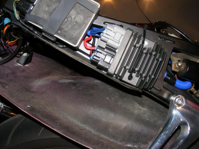

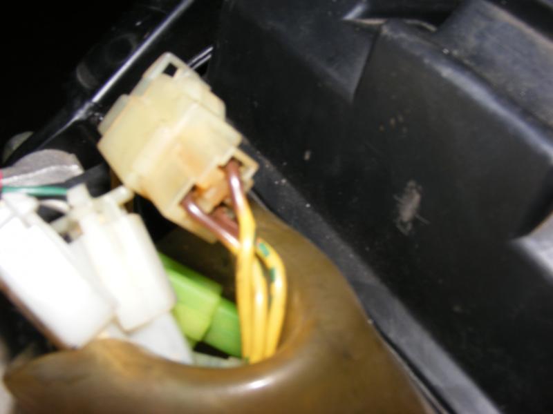

Just my 2 cts. Purchased my replacement thru Beaver almost a yr. ago. No problems since. Have not heard it mentioned much, but make sure & checked the connector under the seat (cluster) where the stator wires connect. Mine had gotten very hot with the OEM unit. Replaced all.
