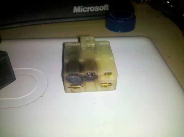

I had a problem with this last week. Bike started fine in the morning but at lunch the starter didn't work; bump starting worked fine, but the lights were all really dim and when the blinkers were on everything blinked.
When looking at my stock R/R, nothing looked out of the ordinary. But using a multimeter, the resistance was HUGE(2.5megaohms) when it should have been minimal(0.7ohm). Here are some pictures of what was going on inside the connector.

Replaced with a new 01 R1 unit, everything is back to normal. Interestingly enough, I think the R/R had been replaced before because it is the newer style finned unit I removed.

The burned/ melted plug is so common even a caveman could find the fault
