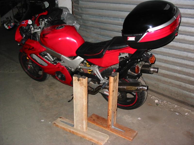

Build yourself 2 of these stands from lumber you "borrow" from your brother in law. It costs nothing since he had some 3" sheetrock screws & L-brackets too. Use that old benchpress bar that you never use & put it through in front of the passenger pegs with some foam pipe insulation as paddng & you got a rock solid stand. I promise you WILL need it again. I know I post this pic alot but since I didnt invent the intermittent wiper I gotta harp on this..
Is there a reason one upright is 90° from the other?
