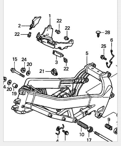

The rubber bit at the front of the box is there yea. I replaced the screws to the box because there were only 4 of 8 on there.
Looks like there is supposed to be some plastic "skins" in the front of the frame but I have nothing there. Maybe too much air is coming in the front end?
Also noticed that the slides had 3 lift holes. Should I cover over the one that was drilled for the dynojet kit?

I have #2 but not #1 or #3
I doubt this is the issue but just tossing it out there. There is so much messed up on this bike its unreal

If the #1 plastic shield is missing that could cause the issue that you are having.
It is another one of those parts that actually needed to be there =)

Holy cow that almost 50 bucks for that plastic part!
Ill start with the stock needles and springs and go from there.

Floyd,
Buy and instal #1 and # 3 ( Not sure what #3 is ) before you do anything else. That part is there for a reason, not sure what but it serves a purpose.
Early on in the piece I removed that part when I first started mucking around with the VTR.
I can't remember the symptoms however I know my bike didn't run properly.
I refitted it and problem solved as bike ran much better. You will have to remove the carbs and there are a couple of clips that hold it in place.
I have seen these parts on fleabay for about $20 bucks.
