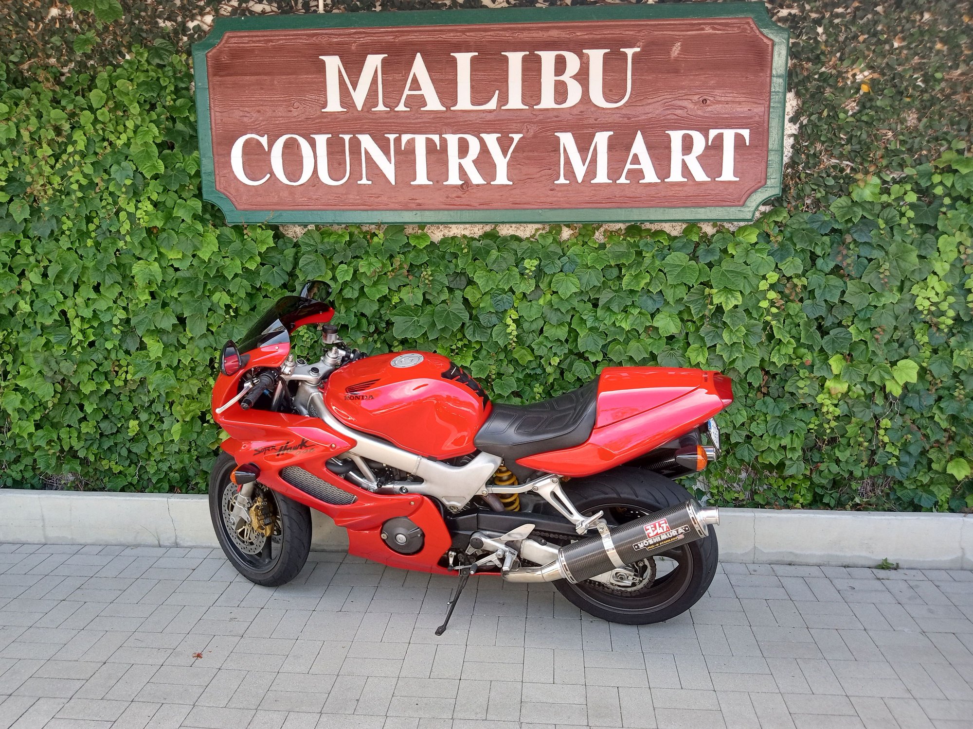

Back a while ago clutch started slipping because seemingly too much pressure was building up in the line. I then proceeded to rebuild the slave cyl., but nothing changed.
Just this week I decided to rebuild the master cyl. I have been swapping old and new parts in the master with various results, but no working clutch.
I think the original problem, was a totally plugged compensation port. I managed to clean that out, but now I'm having the opposite problem from before. I can move fluid through the system and out the slave bleeder, but I can't seem to generate sufficient pressure to actually move the clutch. Pressure out of the master seems good, when I fill with fluid off the bike, I can generate some good squirting straight out of where the banjo port is.
It's a pretty simple system but I can't figure out what the problem is. Should I pull the slave off (again) to have a look?
