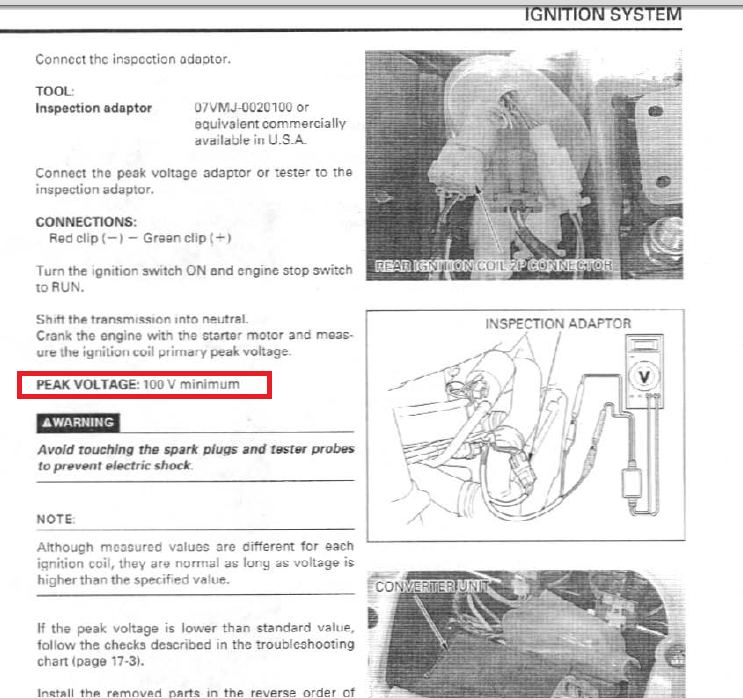

Are you suggesting the coils are grounded out by the converter? Because according to my factory manual they are constantly grounded, and the converter sends a minimum of 100v to the primary side... So I would have to touch 100v to the coil connection briefly to get it to spark.

I'm not sure what to tell you... my schematics (from Honda) are quite clear, the coils are grounded permanently. The coil on my bike has, and has always had a ground from the coil straight to the frame an inch away. It's most definitely powered by the converter. If you say you have 12v at the coil you must have a totally different wiring harness.

http://www.superhawk996.net/Honda_VT...ice_Manual.pdf
Page 371 you will find the schematic for after 00' hawks such as yours. you will see the green wire from your coil connector goes to a frame ground. I highlighted it for you here:Name:  schematic.png

That wiring diagram is showing voltage flow from the coil secondary winding going through the spark plug and across the plug gap to ground.
The primary and secondary windings on most coils (except some waste spark DIS coils) are connected, but the primary voltage is not high enough to jump the plug gap. When the primary voltage is switched off by a transistor, a high voltage spark is induced in the secondary (5,000 to 15,000 volts) which then jumps the plug gap to ground, producing the spark and igniting the air/fuel mixture....then we have fun.
The ignition module contains the transistor which switches the primary voltage on and off.
Again, check all connections including taking them apart and inspecting for corrosion.

Page 17-0 (317 of PDF) has just the ignition diagram.
as impossible as it seems, it also shows the coils grounded with pulsed power. (never heard of such a thing before)
Are you getting the 0.7V pulse to the ICM from the pulse generator that it needs?
Finally a believer! lol I just went out and bought a craftsman meter that had a peak voltage function, and tried to test it last night but by the time I read the instruction manual and figured out how to calibrate it, the battery on my bike was dead lol I think I did see 1.26v but like I said I wasn't using it right so I will check again tonight with a charged battery.

Thats all fine and dandy, except I still don't know which "spark test from the book" you're referring to. The very first thing I did was pop off the plug wire and put a screw driver in it. didn't jump anywhere. Then I hooked up a spark tester (the kind that clamp to something and just have an adjustable gap) and I clipped it directly to the negative terminal of the battery. I'm not sure if you're thinking I haven't tested well enough for spark, but like I've said, I have ZERO spark, not weak, or short, or funny colored. None. Out of either coil.

Alright well I couldn't get my stupid meter's peak voltage feature to work, it gets hung up on "calibrating" which is really just ranging... wish it were manual range. but when I put it to read ac voltage on the pulse generator it clearly shows upwards of 600mv, so at least I can see it is pulsing. I did do a parasitic draw test, and I'm showing 3.89mA, and the spec is .1mA... so I've got a (relatively) big drain somewhere. I tried pulling out my fuses and it remained. unplugged my icm and converter, the plugs for the hand controls, and a couple other random ones and it remained, so I'm not sure where it is but I'm thinking this is my issue... I did notice my new battery didn't last very long when cranking... so I guess I've got some tracking to do...
I think I may just redo my whole wiring harness from scratch... the last guy did a number on it... Anybody know where I could buy the male connectors for our harness?
