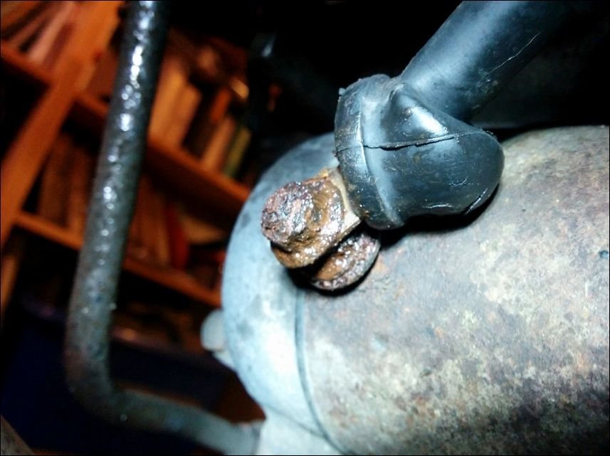

Any sign of corrosion on the starter motor terminal under the rubber hood?
VTR rusty corroded Starter motor terminal
The connection to my starter looks nothing like that it was what I would consider almost perfect under the boot. As a matter of fact I just took it off to clean the inside of the starter and replace brushes seals and bearings. And again I must say this battery is brand new 2 months ago and lives on a high-quality maintainer. I have other bikes that I've tried switching the batteries out of thinking that that was the possibility and same problem. I have even taken this battery out of my SH and put it in my cbr1000 and everything is happy so I've eliminated the possibility of it solely being the battery.
