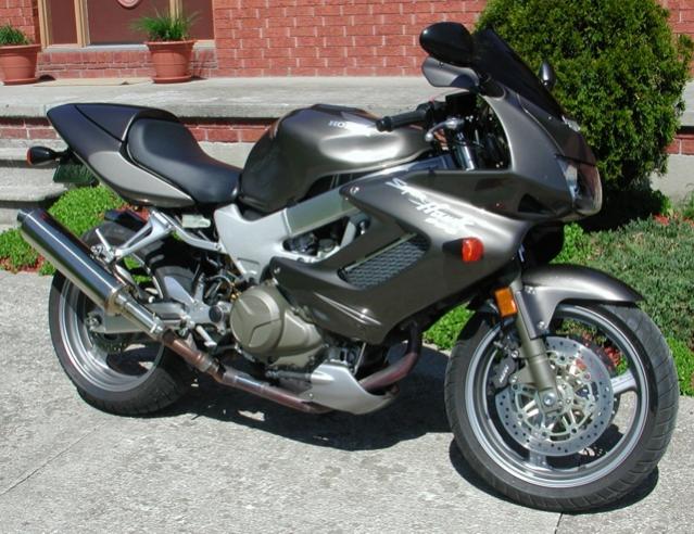

Hi All,
I've been searching and reading posts off and on over the last year.
Picked up an 05 SuperHawk last year.
I'm out in the country, nice roads and several places to give this bike a real romp.
Downside, too far from any dealers to visit every darn week.
Love the pull that this bike has, but getting tired of a gremlin.
Anyone have a similar issue or can offer a solution... Before I give up on this ride.
Here is the story.
Bike is all stock from what I can tell. (different windscreen)
Just over 22,000 kms.
First ride last year coming home from the shop where I bought it.
Up around 200kph starts to go soft on power.
Feels like fuel starving.
Check fuel lines for pinch around back of tank, (big and long fuel lines).
Seems OK, Took it back to the dealer.
They cleaned the carbs and sync. Told me nothing wrong.
Was a little better on response but they are in the city and no way to ride it at 200kph plus. (they wouldn't even if I begged them to)
I hope the issue goes away.
Dealer is very good and wants to help me fix, but time issues, holidays get in the way one family thing after another. I have very little time to keep on top of the time resrtiction when buying a used bike. Plus wife hates me for screwing up the days driving the bike and car into the city.
Over the summer starts to drop one cyl. a good hour or so into a ride. At any speed. It has to be hot it seems.
Check my battery, seems fine in the garage with my multi-tester 13+ volts standing still and the rectifier seems to charge when playing with the throttle. But, I suspect an electrical demon.
Noted a few flat spots with the rectifier (voltage drops) depending on the rev range.
Put on a new rectifier, noted better higher voltage charge under all revs.
Rode the bike... Was good for 2 days.
Problem comes back... Dropping one cyl. again.
Strange part is I could stop the bike turn off ignition, restart and back on 2 cyl. again for awhile.
Figure I have a bad cell in the battery by the end of last season.
Started to have a few slow turns on the starter and not complete starter engage when on the start button by this point.
Store the bike over winter, usual storage stuff.
New battery this year all seems good for 2 days.
Push it hard down my favorite road up over 200kph (my only way to test this issue) Big back fire then drops to one cyl. again.
After a km or so it comes back on.
The bike is hot at this point so I don't really know which cyl. is dropping.
By the time I slow down and check it comes back on.
Every time I throw parts at it... I think I've fixed it.
It seems like I'm slowly killing charging components, batteries over time.
At my rate I'll be riding this thing for 3 years before I find the problem.
Considering new coils and fuel tap.
I may have more than one issue at play here.
Long read, but I figure someone else knows what I'm going through.
Cheers

Here is a pic of my 996.
And a pic of my Yamaha Nytro XTX. (winter fun)
Thanks again guys!!
