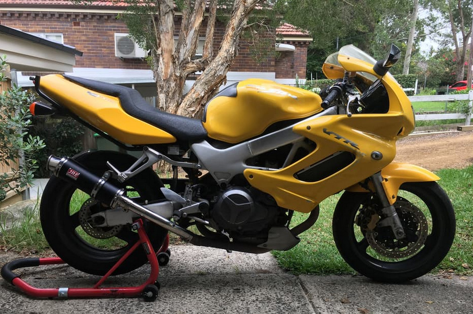

Its been a nice experience, one to not only get back on a bike again but the VTR and that torque is just plain nice. Steering is something I'm not used to, the old GIXXER needed man handling around corners,
this thing just wants to fall into the corners. Bit unsettling at first, but I'm getting used to it.

Pic of the stride below (hopefully it will come up):

Attached Thumbnails Newbie - Suggestions/Gotchas-vtr1000_butts.jpg

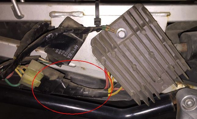

Low and behold, I check the R/R and I am happy to say I do NOT have the standard OEM R/R, I have a big bastard. Pic attached.
So seeing as the R/R has been done, I'm wondering but don't want to guess the CCT's have been done also.
The guy I bought it off works at a Motorcycle dealer, but I don't want to assume they have been done.
Now CCT's are a little different for me to do, basically cause I have no idea what I am doing or looking for.
How do I know if I have ACCT's, ACCT's with the stopper mod or MCCT's?
Pics are helpful, don't worry about instructions on how to get to them as they have been well documented in this forum and
I can follow instructions. Thanks as always.

Which do you have?

Wicky, nice man!! Pics paint a thousands words.
I have the bottom ones, which I assume are ACCT's. (OEM)??
Damn.

Posts: 5,221
Yep, auto's. How mechanically inclined are you? You can really screw up the motor if you do the procedure wrong or mis-adjust the manuals.

Originally Posted by Butts;408003
R/R
Low and behold, I check the R/R and I am happy to say I do [b
What you have a is a cheap Chinese after market diode based RR, and it to will fail eventually. It might be better then an early version OEM one, but its still a failure prone one that will never get you charging performance of a better MOSFET and good install.
Old Oct 18, 2018 | 04:51 AM
Butts's Avatar
Joined: May 2018
Posts: 44
Butts is on a distinguished road
WTF???? Damn not what I was expecting.
Thanks Erik for pointing it out, not what I wanted to hear though.

Old Oct 18, 2018 | 06:11 AM
Id also be very afraid of what is hiding under all that black tape.......Id guess a bodged attempt at wiring
