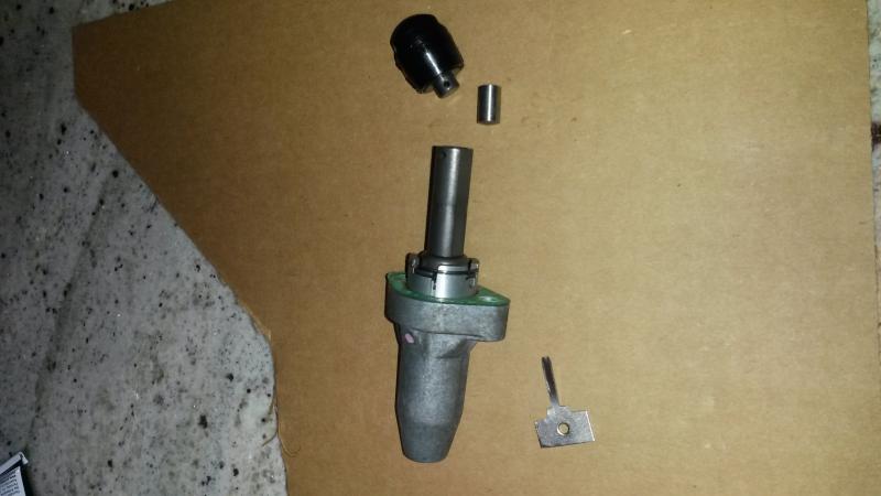

I made a lock key out of one of those thin metal empty slot covers you find on the back of your computer.
I didn't go with manual CCT's . I put a spacer inside the stock CCT so if the spring breaks the stopper will not back out enough to cause damage. Price was $0. I "borrowed" two 8mm dowels from work to use as stoppers.
have you tested this ?
its not a for ever option the chain will wear causing more room between the dowels and when it fails you dont know if it will jump or not, just bore them out and use M8 lockbolts may cost a tinybit more but its safer
Their are several documented instances on the UK site where the stopper mod..saved the day.
Yup at my next valve clearance check I will also check to see if the spacer needs to be re done.... no different then re-adjusting manuals.
I'm not arguing for or against MCCT's. Its just a matter of preference.. I like the cost of the spacer mod ($0) and I still having the auto adjusting feature of the stock unit. I don't have to wonder if I have them too loose or too tight.
Would there be any demand for such tools? I have both sheet metal and sheering machines here to make those....Thanks for the photos!

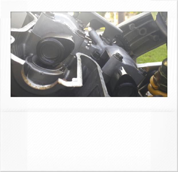

I'm going to do the tear down this weekend. Im doing the "remove almost everything" route. I want to be able to get to everything and visually inspect the timing at the cams.. should have the Kriegers on Wednesday. Thanks for all of the help. Sorry to ask so many questions.
Old Jan 30, 2015 | 01:58 PM

ZERO is on a distinguished road
I did the large scale teardown. Fairing, rads. Everything. What a bunch of crap to remove! Now waiting for Kreiger. Wish me luck.

Done. I did take about three hours. I ended up locking the lock nuts and then removing the acorn nuts altogether. I'll put them back if I ever have to re adjust them. The photo is of the rear before I locked it down. The rear is a difficult bastard to remove and install...

Well done - one less worry!
Usually the front one is the slightly more troublesome one to fit because of the frame and coolant hose limiting but fettling spanner space.
