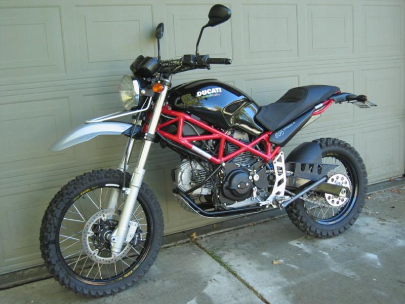

I'll bite, I had a WR426 supermoto that I traded straight across for my superhawk...
I think your success will rely as much on naming convention as it will on fabrication skill. A supermoto, by definition, is a motocross bike with slicks, and you'd probably have as good a shot converting a superhawk into a toyota van or a skateboard.
An "adventure" bike is a much closer proposition... see the honda varadero xl1000, w/ superhawk mill. The purpose of adventure bikes though, ostensibly, is to be able to ride fire roads and double track.
So you have a dirt bike converted to ride on a tight road race course with jumps, or a sport tourer that's been converted to ride on flat off-road with no jumps. The superhawk is naturally closer to one of these, so... What do you want your bike to do?
I think it could be great... but within the constraints of reasonableness. If you want to rip up broken pavement, gas it over train tracks, back into tight corners and tear around fire roads (maybe occasionally go up stairs?) you have my support. Get handlebars and call it a day, or supplement them with lengthier forks and shock. The head tube is not a concern in the least... but remember the swingarm pivots through the unsupported engine case, and if you get ambitious you could break the whole casting.
Attached Thumbnails Considering converting Superhawk to Motard-hpim3237.jpeg   Considering converting Superhawk to Motard-blackbeauty008.jpg   Considering converting Superhawk to Motard-916dirtbike.jpg

"hypermotard" is easy, see pic of modified monster in my post above. That's a hypermotard, in a nutshell... probably with more travel. A hypermotard is just a monster (same weight, hp, everything) with a little more travel and a funny seat/fairings.
Really, just ripping off the fairings and adding handlebars changes the character so much, you may as well start there. I'm converting my hawk into naked right now, pics forthcoming--

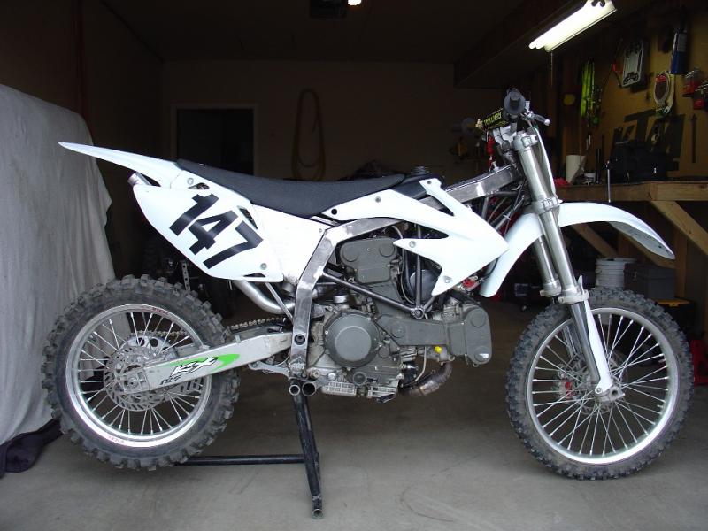

The adventure hawk has been done: https://www.superhawkforum.com/forum...ad.php?t=20164
And here is someone trying a supermoto conversion: http://www.vtr1000.org/phpBB3/viewto...105996#p105996

Hmm, so maybe I'll try taking this one step at the time.
Obviously first comes the front end. I want to see if I can still use the front wheel off the Superhawk in the beginning stages, just to cut costs. Once I get further along, I might buy some Sumo spoked rims so I can be a true hooligan.
If anyone can identify this front end, let me know:
Old Oct 26, 2009 | 04:29 PM
At the start of that thread on vtr1000.org he said they are KTM forks.. Beyond that I can't help you. I don't know what triple that is, or even which KTM that is off of.
But KTM makes some insane bikes, like the 950 super enduro.
http://www.topspeed.com/motorcycles/...r-ar73392.html
So I am sure they have a fork big enough for that.
