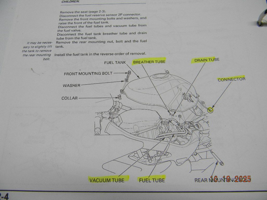

Originally Posted by RK1
The diagram is on page 2-4 of the service manual. If you don't have one you can find the link with the forum search engine and download it for free.
I have the SM, but I need to confirm where the vent, drain, and breathing tubes are supposed to be connected at the other end (I bought the bike last month with the tubes disconnected). Any ideas where I can find a diagram, photo, or drawing that would show me the correct connecting points?
Old Oct 19, 2025 | 08:32 PM
Posts: 1,999
I don't remember seeing a posted photo here, Likely there is, finding it might take awhile.
The hoses connect to the bottom of the tank. The nipples are different sizes, as are the hoses. Exit left side, about even with the bottom of the engine.
Old Oct 20, 2025 | 10:01 AM
Oldrider78's Avatar
Joined: Aug 2025
Posts: 28
Oldrider78 is on a distinguished road
Aha, found the diagrams at the front of the Service Manual! I have attached photos of the appropriate diagrams here. Bottom line is that the breather and rain tubes are open to the ground. BUT, the vacuum line going to the Petcock needs to be attached to the engine somewhere in order to draw a vacuum on the Petcock to open the diaphgram, right?
Old Oct 23, 2025 | 06:05 PM
Posts: 1,999
Base of the carb/intake runner should have a fitting for the line from the fuel petcock to attach to .
