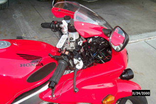

I added driving lights in 2000 to my 98. I ran from my auxilliary power terminal block via a fuse with 16 ga wire to the relay that is triggered from an ignition-on circuit thru an illuminated rocker switch mounted on the left clip-on for my twin 55-watt lamps that are mounted on the end of a clevis cut into aluminum tubes bolted to the inner black "cooling ducts" that extend out from the fairing nostrils. It helps having a volt meter to monitor all my added electrogizmos.
Attached Thumbnails Need some opinions.-ba-vtr-rt-cu-c.jpg   Need some opinions.-ba-vtr-ft-cu.jpg
