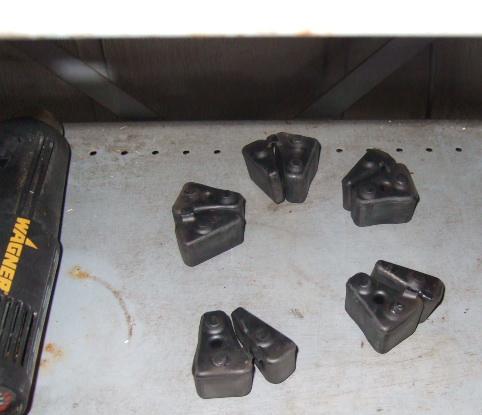

what are these and should i replace them? PIC
Old Mar 30, 2008 | 12:05 PM
andy9743's Avatar
Posts: 310
i've never taken a bike apart before and was surprised when i removed the rear wheel and found these...what do they do? should i replace them as the bridges that connect 2 of them are broken, or can i glue them back together?
thanks guys
andy

Old Mar 30, 2008 | 12:21 PM
Posts: 2,223
thanks guys
andy
Clean the rubber driveline damper blocks and use some good electrical tape to reconnect them, then install them and check for a loose fit in their rear sprocket hub cavities. If they are loose, cut up an old inner tube for shims and reinstall them with a tight fit. Clean and silicone grease the sprocket hub O-ring and be sure the sprocket hub fits properly and fully into the wheel. Check the rear sprocket, chain and countershaft sprocket for wear; replace as a set if necessary. Lube and wipe the chain and check the rear sprocket nuts for proper tightness, reinstall the chain and rear wheel and tighten axle nut to 69 Ft lbs; the chain will tighten up when fully torqued so have the chain a bit loose when the axle nut is only just snug during alignment. Do not use the chain adjuster index marks other than for rough alignment. Use a milimeter pocket scale with a sliding length indicator to align the wheel on each side so they are the same. Measure from the end of the adjusters above or adjacent the adjuster locknuts to the end of the swing arm; and/or use the parallel string method.
Old Mar 30, 2008 | 03:51 PM
Mnvtrryder's Avatar
Joined: Feb 2008
Posts: 16
From: Eagan, MN
Mnvtrryder is on a distinguished road
I used silicone gasket sealer to reattach mine, strong enough to hold them together but yet flexible and pliable.
Old Mar 31, 2008 | 02:48 AM
Reinske's Avatar
Joined: Dec 2007
Posts: 66
From: Germany
Reinske is on a distinguished road
They don't necessarily need to be together, but they must be mount... And they only fit in one position. They shall be a little "soft", if they are very "hard", you should replace them. ( Sorry for the vocabulary... ) You know what I mean? "Soft" like a rubber, you know? They shall damp the rear wheel movement, so the wheels acceleration is smoother... ( Oh man, vocabs again... )
Old Mar 31, 2008 | 06:21 AM
FL02SupaHawk996's Avatar
Fastest Color
Posts: 2,091
From: Lithia, FL
Andy, they are called a rear wheel damper set and run about 20 bucks at your local dealer. If you have any play in your drive-train at the rear wheel (not lateral but forward and backwards) they will need to be replaced...they do wear out from compression cuz we gots some torque and from drying out, so replace them when you're ready...simple as that...I replaced mine at 12K miles when I started getting a lot of play that I could actually detect when changing gears...

Old Apr 22, 2008 | 01:31 PM
Timmybung's Avatar
Joined: Apr 2008
Posts: 26
From: Southern NH
Timmybung is on a distinguished road
Typically referred to as the cush drive (i.e. cushion).
Old Apr 22, 2008 | 04:35 PM
andy9743's Avatar
Posts: 310
huh definately didn't know that...you guys have no idea how much i've learned on this site!
Old Apr 22, 2008 | 04:36 PM
andy9743's Avatar
Posts: 310
oh and i just replaced them while it was apart, thanks guys

Old Jul 7, 2008 | 04:58 PM
haknslash's Avatar
Posts: 702
From: Bham, AL
I was cleaning up the bike last night and noticed my sprocket has about 1/8th of "play" if I hold my wheel and try to turn the sprocket. I read in my manual on the rear wheel disassemby and saw this damper rubber. I would imagine the damper rubber (if bad) would allow for this 'slop' in my sprocket? My bike has 13.5k miles on it. Wondering what else might cause this play and also why so early on or what might be the cause. TIA

Old Jul 9, 2008 | 05:37 AM
Fastest Color
Posts: 2,091
From: Lithia, FL
Yep, you need to replace your rear wheel damper set:
http://fiche.ronayers.com/Index.cfm/...oup/REAR_WHEEL
I've done it and it's easy as pie
RC
