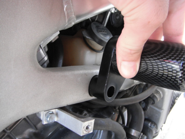

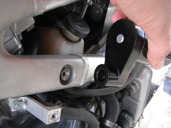

996Riders's Avatar
Joined: May 2010
Posts: 79
From: mesa,AZ
996Riders is on a distinguished road
Im not sure what your talking about so i took a couple pics.
Attached Thumbnails need a lil help-dscf0364.jpg   need a lil help-dscf0363.jpg
Old Aug 1, 2010 | 02:19 PM
Well the reason you want the right kit is that it comes with new engine bolts that are long enough for the job..

Old Aug 1, 2010 | 07:38 PM
NooB's Avatar
I loves me twins
Joined: Feb 2010
Posts: 380
From: Houston, TX
Yep, you got the right idea. Pull those bolts out of each side and one should be longer than the other. You're hardware kit should have two different lengths of bolts. I can take a photo of mine if you'd like.

Old Aug 1, 2010 | 09:42 PM
Originally Posted by 996Riders
Im still needing to know how to remove the old to do the new... anyone ? bolts can always be bought if needed? it came with a set.
just stick a wrench on it, and remove them one at a time. the engine will not fall out.
I thought I was missing something as I stuck a socket in there trying to break it loose and no bueno, didnt budge a tiny bit at all.. figured there may be some special tool looks like there would need one for the left side..
Old Aug 2, 2010 | 11:35 PM
ranchomice's Avatar
Joined: Nov 2009
Posts: 677
The particular bolts used are actually engine mounting bolts! You can't just "buy them" as they are longer with the proper kit to compensate for the depth of the mount. I wouldn't mess around trying to make a 1000RR slider fit on the wrong bike, but that's just me. If it were me, I actually wouldn't use that type of slider at all.
