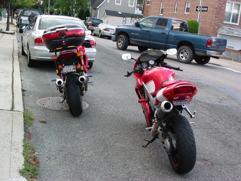

I have 2 vtrs, one 2 into 1 devil carbon, one two brothers dual slip ons. I like everything about the 2 cans better. Throttle response, sound, etc. I think its way easier to tune duals since I have spent alot of time tuning both.
The 2bros are actually high mounts that I converted to low mount to accomodate the givi rack. Doest like as trick but funtions way better.
