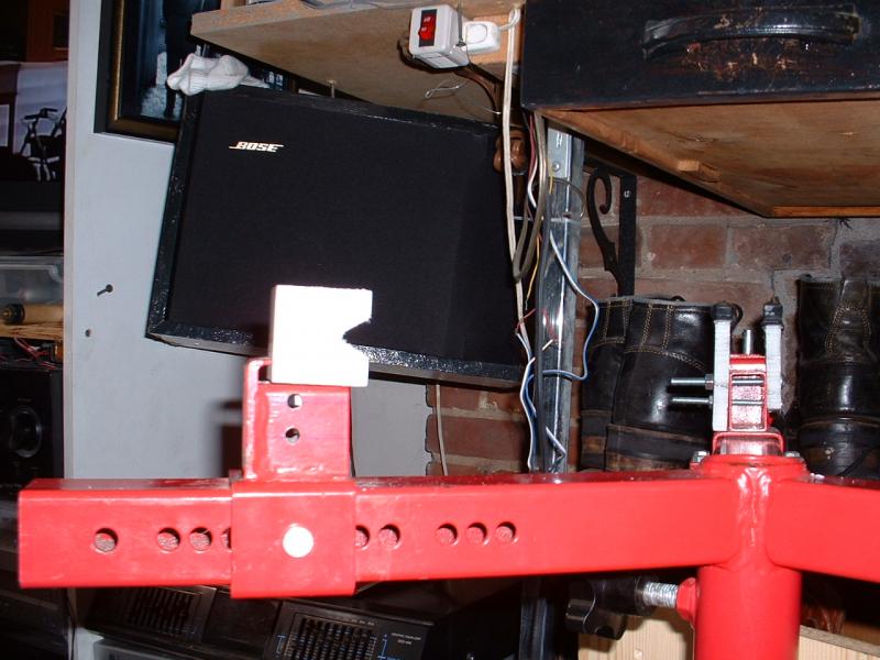

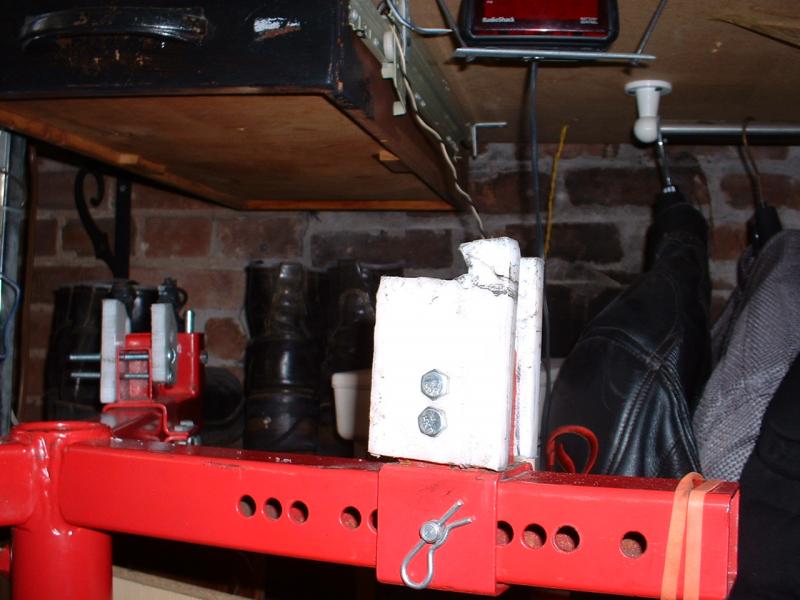

It looks like its too far off the ground to get leverage. I have a similar setup but those steel claws will maul your wheels. you want to make blocks (or get mojo blocks) to hold the wheel w/o gouging them. This is a great bar to get
No-scufftiretool
http://www.angelridevideos.com/reviews/Mojo.html.

These are the cutiing board version that were on mine when I got it. I did one change with them & replaced them. Not very stout especially when changing rear tires. The mojo blocks are like $30 & I made mine for about $12 with delrin from mcmaster-carr. You can hand or jigsaw the stuff then bolt it on.
Attached Thumbnails my new tire change setup! :D-p90x-pics-tirechngr-026.jpg
