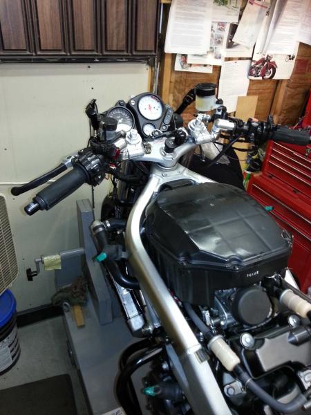

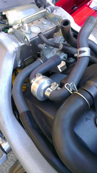

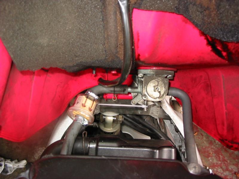

Not sure if you guys do this but I have been trying to install fuel filters for like 2yrs now. Finally got some that would fit and put em in.
Read an article about a guy who had crud from the tank trash his carbs and know that feeling all too well. $10 for the 2 filters so very cheap insurance.

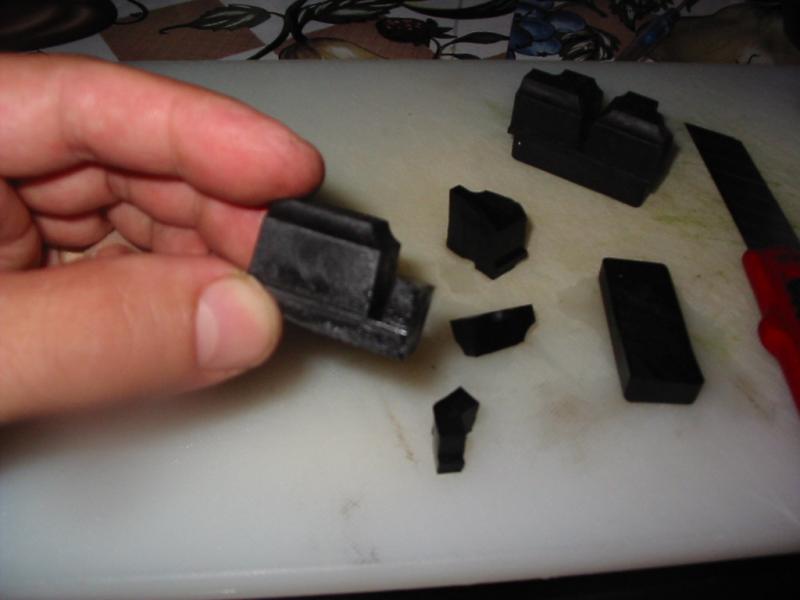

Also carved a new tank rubber mount (side one) out of hard rubber.
Attached Thumbnails Fuel filters installed-bearmt-2013-004.jpg   Fuel filters installed-bearmt-2013-003.jpg

That filter looks like the ones sold at Advance Auto. I was thinking about using something like this as well, just never got around to it yet. If possible, could you tell us the rough dimmensions of that filter, so we know what in fact fits in that space?
Old Aug 11, 2013 | 05:47 PM
Well, that is why the pic. Its like 1.25" x 1.25". I took the pic before installing the 2nd one, but the 2nd one went on the straight part of the tubing. (just behind the throttle cable linkage)

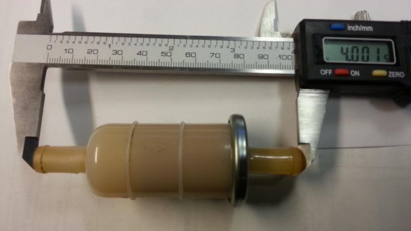

Just do this and you can diagnose all of your problems at once
Old Nov 1, 2013 | 09:21 AM
Posts: 2,223
Originally Posted by FTL900
I got one similar to this at O'Reilly auto parts for about $4. Home Depot carries them as well, for lawn mowers.
I like having a totally clear filter, it makes diagnosing fuel problems much easier.

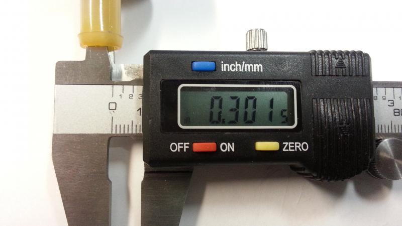

What is the I.D. of the inlet/outlet as well as the O.D./I.D. & length of the filter "body" of this filter? The VTR carburetors are the largest Honda ever used on ANY vehicle, and as you know the VTR is a thirsty beast and requires unimpeded flow rates. The EMGO 14-34481 has done the job for me and I'm concerned anything with less than the OEM hose I.D. (+.301"/7.7mm) and a smaller filter body section volume will be too restrictive.
See attached pics of the EMGO filter.
Attached Thumbnails Fuel filters installed-emgo-14-34481-fuel-filter-1-c.jpg   Fuel filters installed-emgo-14-34481-fuel-filter-2-c.jpg
Old Nov 1, 2013 | 01:00 PM
FTL900's Avatar
Posts: 250
From: Seattle
I don't have any idea, but it flows fuel pretty well. There's another one that I prefer that's more slender, so it's easier to place inline.
Old Nov 1, 2013 | 02:28 PM
Posts: 2,223
That's a scientific response if I ever heard one.
I still am not clear on either filter mfgr/part number.
Filters are rated by gpm and psi output. The EMGO filter is actually rated to feed a Honda GL1200/1500 and other larger displacement engines...
See pic
Attached Thumbnails Fuel filters installed-03-24-13-ba-vtr-tank-frg-off-c.jpg
