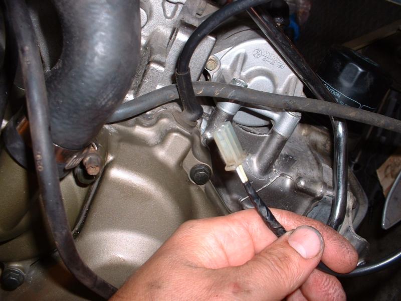

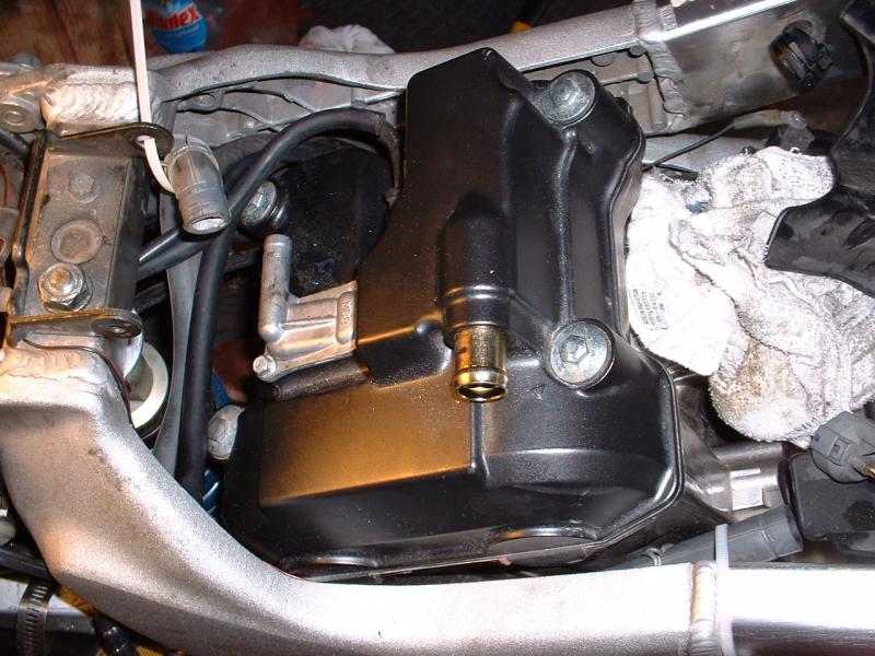

OK so the motor is nearly swapped but what are the large nipples on the top of the cylinder heads? Pair system? I blocked off the pair valves so can these be covered? Also where does this small connector from the front of the motor go? I think its the pulse generator but cant find the connection

Those large nipples are for the vent lines to the air box. Not sure about connector
Old Aug 15, 2011 | 02:23 PM
Wicky's Avatar
Posts: 1,707
From: Essex, UK
speedo sensor connector? Does it come from the back of the engine nr the CCT?

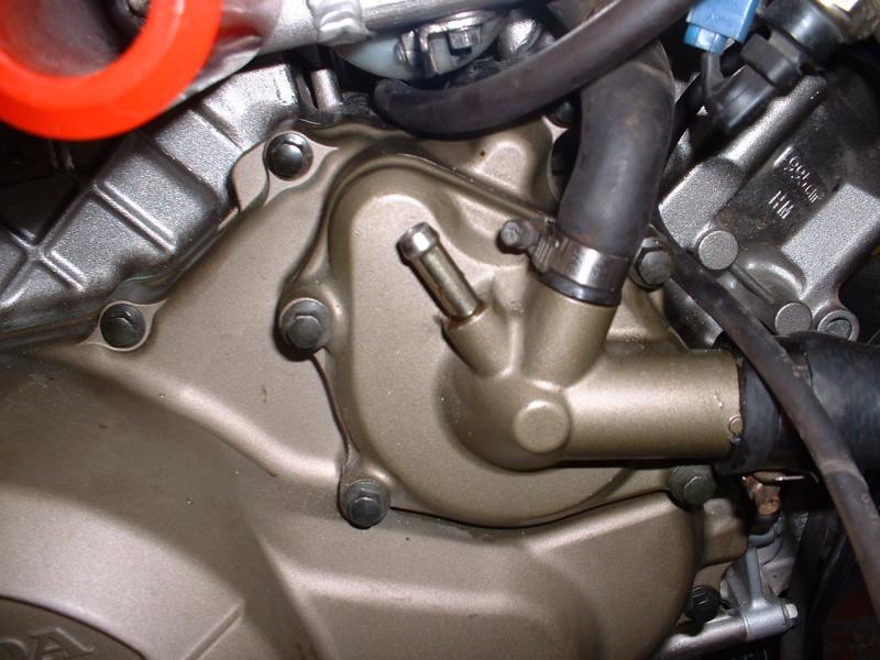

OK so nevermind those 2; I got em,, where does this blank nipple off the right motor go?
That looks like the return cooling circulation pipe from the carbs. Refer to page 115 in the official VTR service manual.
Old Aug 15, 2011 | 03:58 PM
+1 Show us where it comes from.
And the other connector does go to the one of the bottom nipples on your front carb.

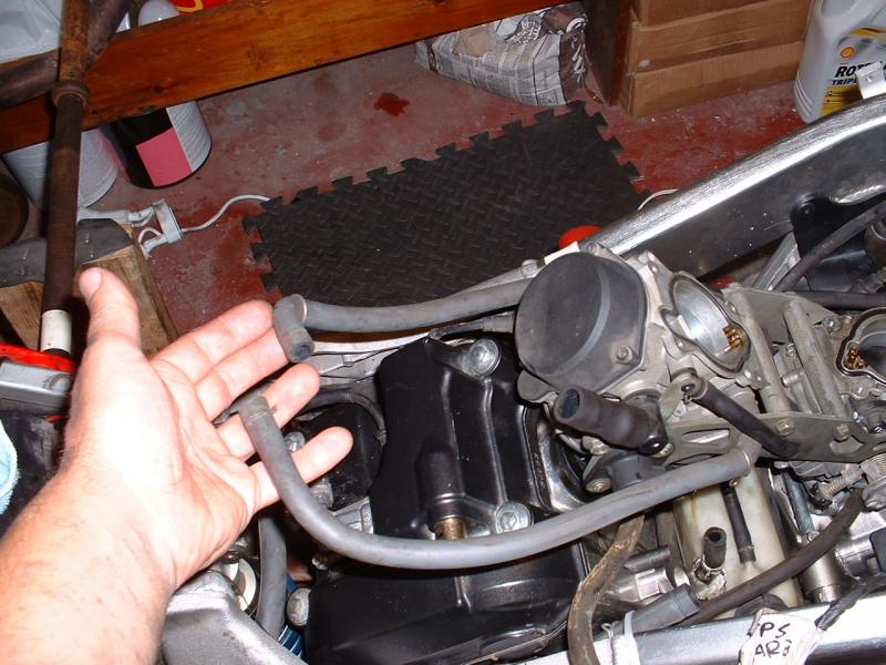

OK found that out when I went to reinstall the carbs. Now what are these hoses off the carbs?
Old Aug 15, 2011 | 04:40 PM
saige's Avatar
the boss
Posts: 1,182
From: largo,fl
gas lines going to petcock on gas tank.
