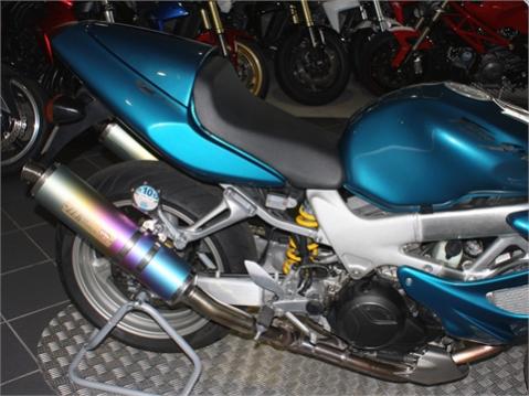

Moriwaki's are about the best sounding cans out there for a SH IMO. Check out this video of a pair with high mounts. (At 1:36 I just about touched myself) If you EVER want to part with them please let me know!
Tracy
PS: Here's a pic of one with low mounts
