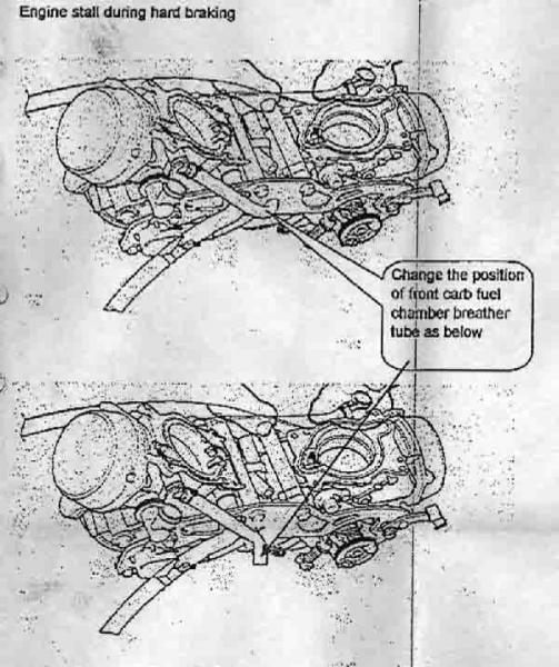

Do the float bowl vent lines still cross between the carbs? If so remove them from the carb stays and route them so they just point straight down.

so i would pivot the air fitting in the carb and point them down, probably make the hoses shorter too, or just get rid of the hose?
i will do this, but can you tell why that works? there is still 1 atmosphere of pressure at the end of the hose. does some of the fuel leak out of the vent and stop of the tube for a short time, and this mod lets the fuel fall out instead of becoming trapped in the horizontal section of vent pipe.
Old Aug 26, 2011 | 11:07 AM
Well it's from a service bulletin that was released in '98 and generally only effects the earlier bikes but what is happening is the hole through the carb stay is a touch undersized.
What this does is very slightly pinch the vent line. So what happens is when you are going down hill, on the brakes, the rear carb pukes a bit of fuel into the front carb and you end up running on one cylinder until it clears out.
The bulletin stated to just remove the vent lines from the carb stays (where they cross each other) and just point them down instead of going through the stay. You can cut them down or whatever you want.
Sounds pretty simple but it really does work....

my vents are not linked together so i don't think one overflowing vent would allow fuel into the other carb's vent.
but they do travel horizontally them make a 90º bend and then into the holes in the carb stay.
any chance you could tell where to find that service bulletin? i would like to see some pics. when i first bought this cali model bike back in 99 i immediately removed all the PAIR and carbon can junk. so i have no idea what the float bowl vent hose routing for a 49 state model looks like.
yes mine is a very early model, it has SN# 43, yes the 43rd chicken ever produced

Old Aug 26, 2011 | 11:32 AM
The vent lies are not hooked together...... it comes from the throat of the rear carb, up the long stack and into the short stack......
No I have no link or pics, just a good memory.....lol and all the bikes (49 state or not) have the lines routed the same way. It was fixed in the later models, so it is only on the earlier bikes that you need to do this.

Old Aug 26, 2011 | 02:11 PM
Though the one I saw had you reroute both lines......
