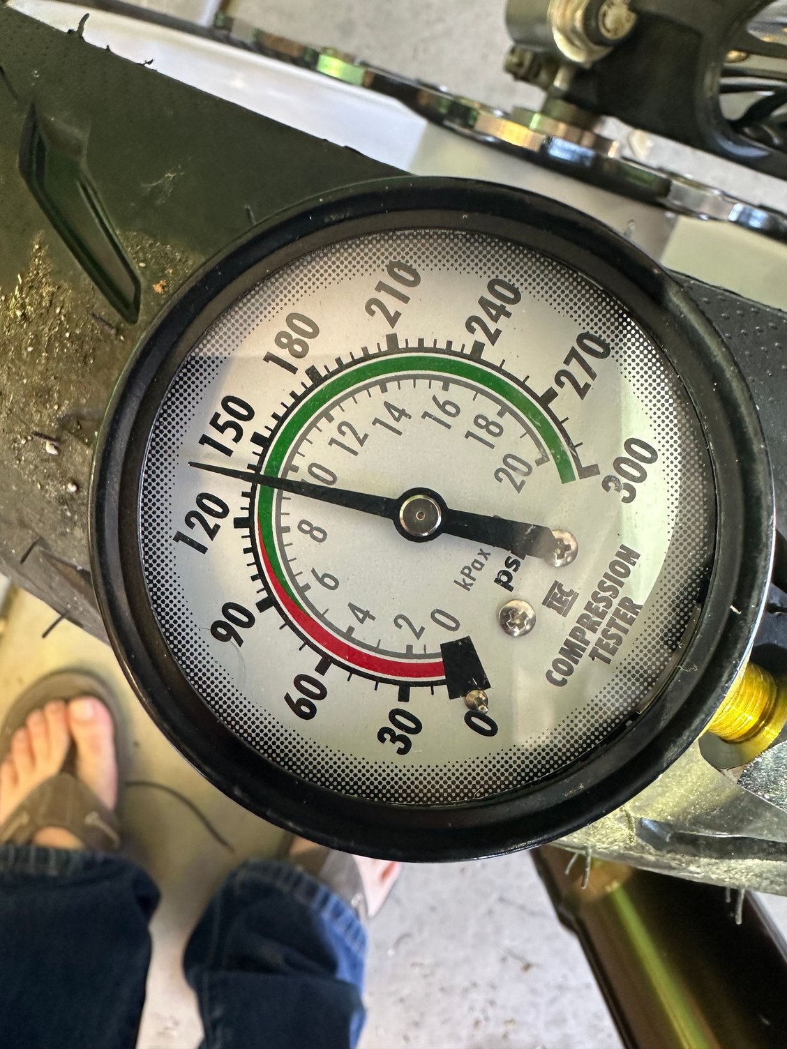

Old Apr 27, 2024 | 01:42 PM
Squid's Avatar
Joined: Apr 2011
Posts: 510
From: Edwards AFB, CA
My findings
The first picture is the front, the 2nd is the rear

How confident are you in the accuracy of your compression gauge?
It's nothing expensive...tested it numerous times and got the same results.
Squid- thanks for sharing your readings!!!
How's she running??
I was worried the compression was expected in the >160 ...this is promising.
Now if I could just find the tech manual and a little time to check the timing
