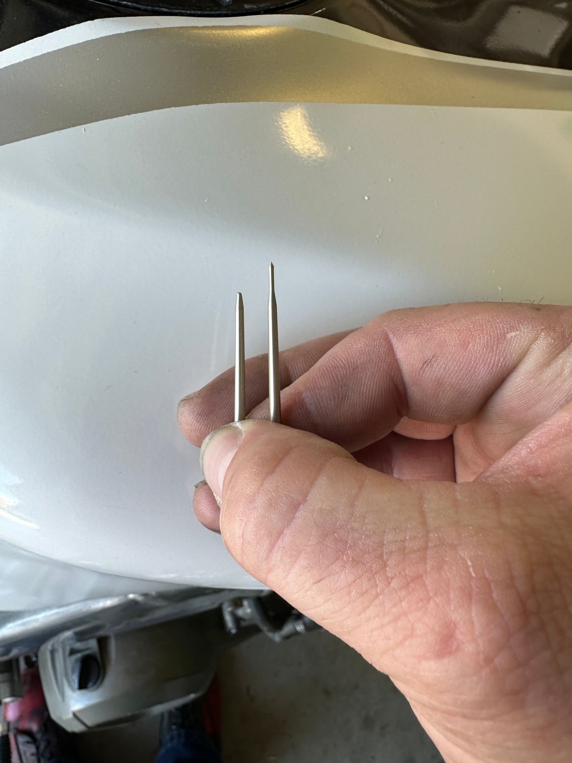

Found out why it would die.

I was hoping that I wasn’t going to have to pull them, but I’m glad I did. I always worry about tearing them or pinching them upon reassembly. It’s a pain getting them to seat right when putting the cap on. I did figure out that if I used a small piece of 3/4” pvc and used it to rest the slide on it helps get the diaphragm into the perimeter of the carb body.
