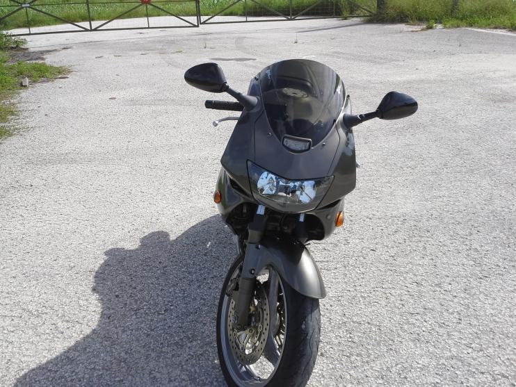

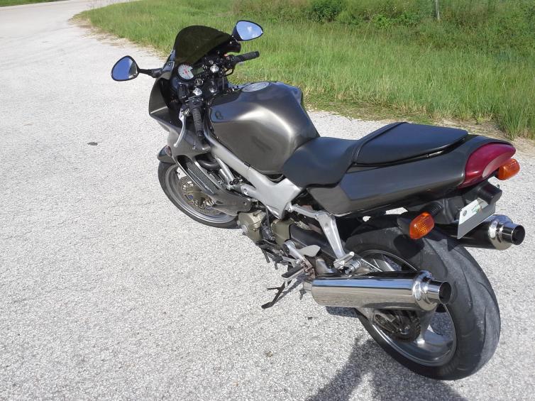

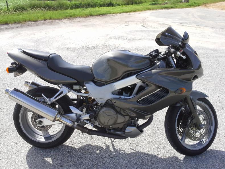

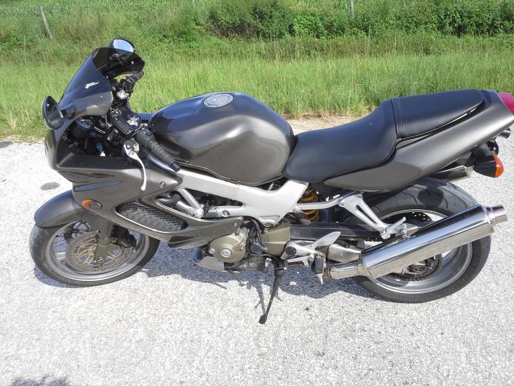

Hallelujah, Hallelujah, Hallelujah, Hallelujah, you know how the song goes.....Just took my Hawk for a long ride after more than a month, and snapped a few pics for the forum! It took me a week to get her together and she is running better than new after the carb re-jet, neutral position sensor change, and a few more modifications I made during the tear down. The PVLIR thread was invaluable, since I completely forgot the vacuum and fuel line hook-ups. If you don't know what I am referring too, review this thread! The only other mod. I plan to make is changing the exhaust in the near future. Like those Devils, so on the hunt. Thanks to all. Ride Or Die my friends, Ride or Die!
Attached Thumbnails Laid her down, but oh so gently!-final-2.jpg   Laid her down, but oh so gently!-final-4.jpg   Laid her down, but oh so gently!-final-6.jpg   Laid her down, but oh so gently!-final-7.jpg
