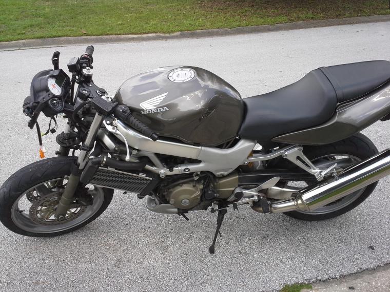

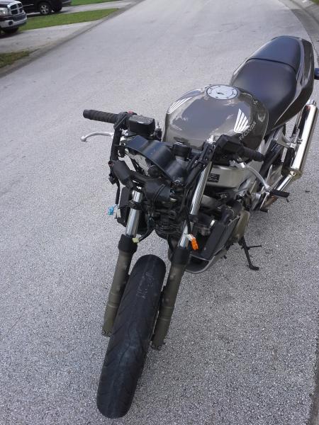

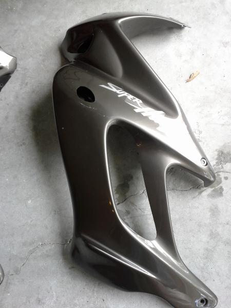

Me again forum. Last week I had to lay my baby down, as I was taking on what I call, Dead Man's curve on one of my back roads. For the most part a lot of cosmetic damage but my forks are also bent, and the lower case assembly for the speedometer and tachometer needs to be replaced. I was fully geared, so only have my hurt pride and a few bruises! After getting things broken down, I have a few questions. First, I want to correct a nagging problem. After riding for a couple of hours, she won't initially turn over after shutdown. I have to let her sit, normally 10 minutes or so, and then she cranks up fine. R/R has been replaced, battery is good, kill switch is not engaged and working, plus wiring has been checked. No clue on this one, so appreciate some help! Next, I am showing pictures of the upper right and lower cowls. Tips are completely broken off, and want some suggestions on if I should fix existing, or completely replace. Finally, I would like to put on some new carb's. Best suggestions from the group. Plan to repaint everything with original color since I am breaking her down. Pictures attached, so let me know if you recognize any other corrections with the Eagle eyes of this forum. Much Appreciated!
Attached Thumbnails Laid her down, but oh so gently!-naked-1a.jpg   Laid her down, but oh so gently!-naked-1.jpg   Laid her down, but oh so gently!-naked-3.jpg   Laid her down, but oh so gently!-naked-7.jpg   Laid her down, but oh so gently!-naked-8.jpg
Old Jun 16, 2014 | 06:02 PM
The fairings are ABS, and may people have had great success fixing them (if you're re-painting it seems like a good use of time rather than buying new ones). I think some people just get zip ties (which are ABS) and use them to weld the whole thing together with a soldering iron or similar. Something like this:
Motorcycle Fairing Repair on abs plastic - Melting abs plastic Part 2 - YouTube
Never done it myself, but it seems applicable in your situation.
Are the shutdown problems a result of the lay down, or were they happening before?
Why replace the carbs? Seems arbitrary...

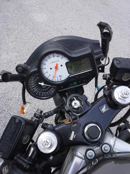

Thanks 7moore7 for fairing suggestion. Shutdown problem was occurring prior to lay down, and I feel this is a good time to really address. Carbs are a want along with fork modifications.

no point in replacing your carbs. Go through them, clean, and adjust perhaps, but replacing them is completely unnecessary.
Oh, and no offense, but at no time, ever, do you "have to lay it down". Crashing is human error, nothing wrong with that, but spinning it like you did it on purpose means you learn nothing from whatever event caused you to crash.
You learn from it, and you grow as a rider. No fault in that, we've all been there.
Good luck with your repairs. I've had good luck as 7moore7 said about the zip ties. I'd pick up some screening or fiber tape to re-enforce the back of the cracks as well as some "plastex", (I've used plastic bumper repair kits in the past as well).

Thanks Matt, now that I finally got some sleep let me clarify. I do plan on cleaning and adjusting the carbs, to help her run a little bit leaner. What I also plan to replace is the exhaust. This is what I was looking for suggestions on. Been traveling for work, while also taking care of family, so my original message was a little off. Want an exhaust that looks good while also performing well on SuperHawk. Seen some great examples on other threads. Also need some help with shut down problem.

Your starting issue, if when you turn the key on you get power and you hit the starter button which reults in no turn over makes me think of 2 things. 1, bad starter solenoid. 2 bad side stand switch. Check connections on both of those.

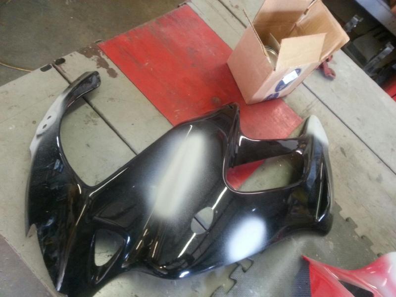

Thanks everyone! Found someone today who can redo my fairings, but we are searching for a complete fairing to compare since both mine are damaged. Couldn't find anything out there which show dimensions, hole locations, etc. Anyone else come across this issue? Called local Honda dealership and no go! Any local Superhawk riders in the Orlando area willing to drop by Bikes Only Body Shop, just off John Young Pkwy, at 3609 Old Winter Garden between 9-5:30pm shoot me a PM. I'll buy you a beer! This guy does great work at a reasonable price.

imo check the starter first, as a bad side stand switch would make the stand light on the dash flash or remain lit no matter the position of the side stand.
In my case, the fault was a malfunctioning neutral sensor, when the bike was hot it wouldn't read when neutral was on, so I had to use the clutch to start it. But that's easy to check (neutral light won't light up), unless you're experiencing some bad karma coincidences, like a broken/burnt bulb along with the sensor issues.

Plan on replacing the front fairing stay with a brand new one from Honda if it's bent. These are very unlikely to align straight ever again if bent. Don't bother wasting your time and money with used ones either. Just my opinion.

Jonar, you are spot on with my issue. When my bike gets hot, it has a hell of a time finding neutral, and when I attempted to shift from 1st to 2nd it would appear to get stuck in neutral for a moment. When I shut down, it could never find neutral so I would have to wait several minutes for it to cool down, before it would start. Checked connections for starter solenoid and side stand switch and they are fine. I'll change the neutral sensor and see how things go.
CrankenFine, I know it is difficult to see from pictures, but luckily fairings were not bent. My zero gravity windshield imploded, and pulled the tips of the fairings off with it. I just have one long crack on right upper, and need the tips re-molded. This is why I am going with my body work professional, and still looking for some specs or someone in area to assist. He's fixing and I'll be painting. Appreciate all of your input.

Looks like your fairing stay may be bent too...gotta watch for that, when you try to re-assemble it, things wont line up right and will crack over time. I tried bending mine back into shape when I went down, no luck....
And body work is a total time suck if you want it to look nice and not like you spary painted over everything...may be wiser to suck it up an find replacements on fleabay. Just my thoughts...Then paint, thats $$$ an clear coat, an more $$$ LOL I think i was out close to $800 after my low speed collision with an errant driver. Bent forks, fairing stay, broken fairings, headlight, windshield, bent brake lever....damn lol

If it turns out to be the sensor, there might be an easy fix. Waiting for your update while I ask my mechanic his exact moves to share it with you.

The OEM Honda fairings you get from Ronayers or Partzilla are brand new painted (with decals) Honda parts. With regards to the exhausts I think it's mainly going to come down to your own personal preference. I personally have never had any of the "chirping" issues I've heard others complain about with the Leo's. Seems to be related to the end cap and dB reducing insert. There's some good info posted up here elsewhere on the subject. Otherwise I have a pair of carbon high mounts (not sure if they're still available) and the fit and finish is really nice. The nice thing (again depending on your taste) about the Yoshis, at least the street slip ons that are probably the only ones still available, is they're the only slip ons I've heard that even resemble quiet. I was also very impressed with the quality of the Delkevics and if you're buying brand new they're priced pretty reasonably.

Jonar, I ordered the Neutral Sensor, fairly inexpensive, and anxiously await your mechanics feedback. I've also been researching the replacement and will tackle after forks are completed.

Lol, my possible fix had to do with repairing the faulty sensor, not buying a new one
Anyway, I guess since you've done it it's all for the best, just install it and check if the problem persists. If you need help installing it just let me know, I might be able to guide you from overseas

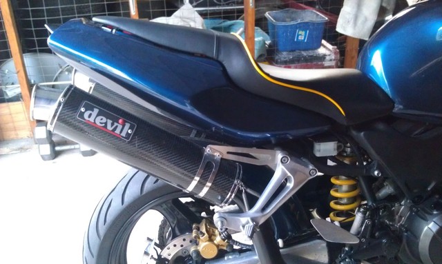

I looked up and down for Devil cans because they had the best sound I heard for VTR cans on U-Tube. Sadly, they are no longer available.
I'm jealous Captain C, but I'm glad somebody got a good pair of Leos.

As far as mounting new fairings I've found it useful to mock them up, then eyeball lining the holes up with the mounting brackets. I lightly tap the mounting brackets with a plastic mallet until the holes line up PERFECT, and that way you don't put unnecessary stress on the fairings (Yes I've seen brand new ones develop stress cracks around the holes because they didn't line up perfect). Post up some pics when you're done. I'm curious to see your results with the Colorrite paints. Good stuff but it ain't cheap!

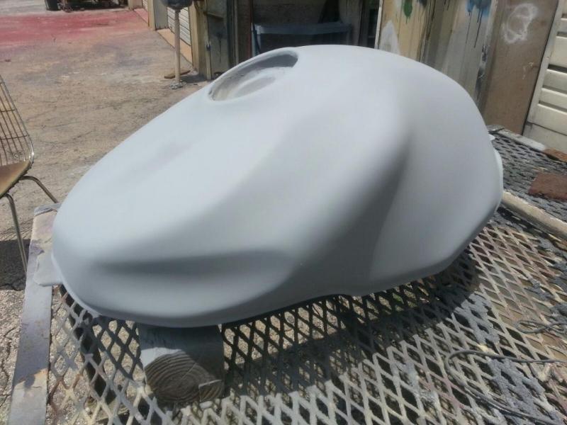

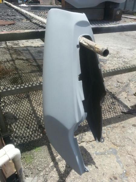

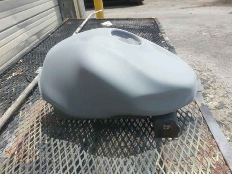

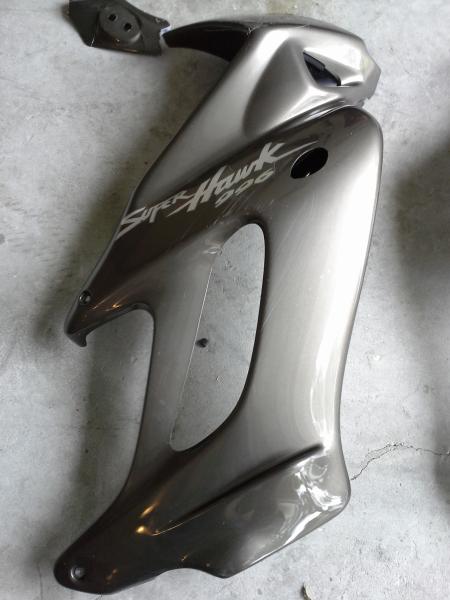

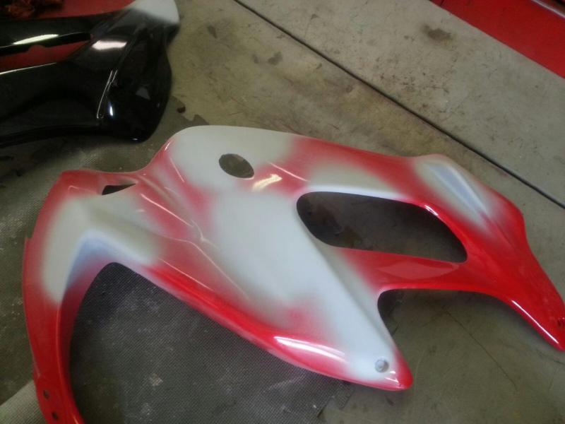

The tank, fairings, and tail cowl have been repaired and primed if needed. Many thanks to my friend Jose at Bikes Only Bodyshop in Orlando. Now I understand why having your pieces professionally done can be expensive. The work is very labor intensive and time consuming, if you plan to do it right! We'll be block sanding, then wet sanding this weekend before I finally paint and clear coat. Almost at the end of the road, and my Hawk will be rolling again....
Attached Thumbnails Laid her down, but oh so gently!-primed-2.jpg   Laid her down, but oh so gently!-primed-1.jpg   Laid her down, but oh so gently!-primed-3.jpg   Laid her down, but oh so gently!-primed-4.jpg   Laid her down, but oh so gently!-primed-5.jpg

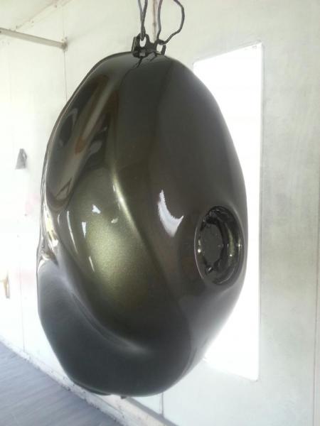

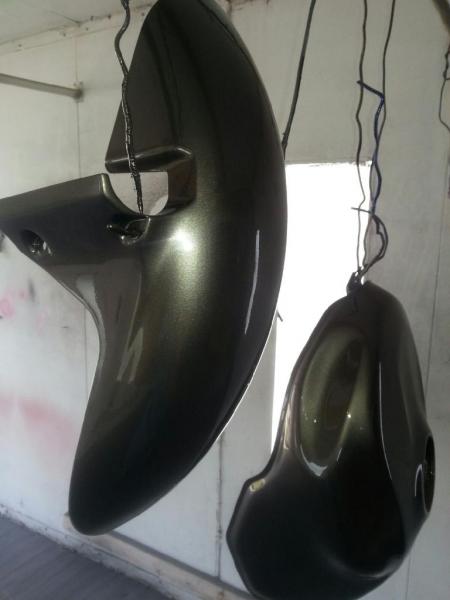

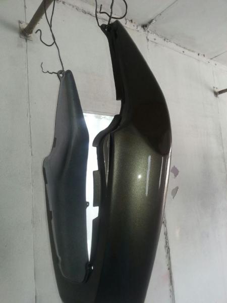

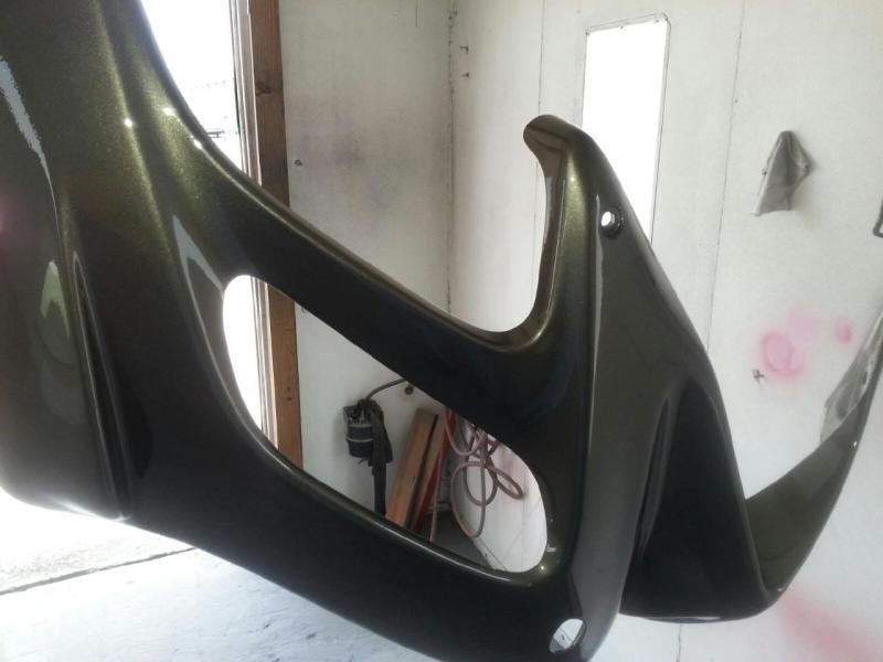

Here are the photos of the completed painting and clear coat for my Hawk. I'm very happy with the outcome. For you would be painters, be prepared for long hours, plenty of sweat, and patience to get the job done right. I'm reassembling my Hawk now, and will have completed photos this weekend. Finally see the light at the end of the tunnel, and looking forward to a long ride. Thanks to all on the forum that helped me get here!
Attached Thumbnails Laid her down, but oh so gently!-paint-1.jpg   Laid her down, but oh so gently!-paint-2.jpg   Laid her down, but oh so gently!-paint-3.jpg   Laid her down, but oh so gently!-paint-4.jpg
