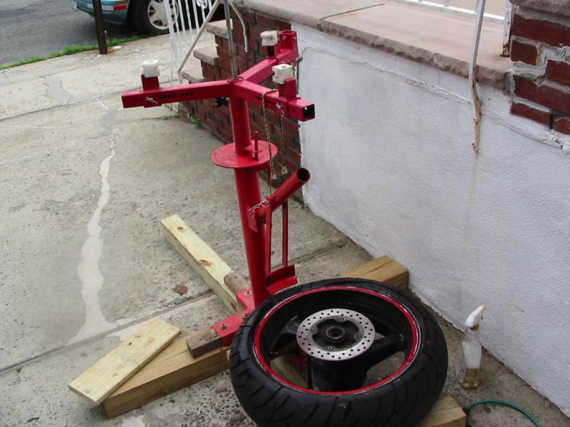

Yeah, thanks man that helps. I am for sure doing it myself. I guess tomorrow I will call around the city for a tube, if I order one I gotta wait too long.
Hoping someone has one. Will update this monumentous undertakng. Oh and I also ordered a brand new rear tire as a back-up plan.
